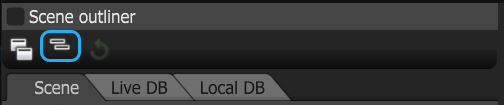

To collapse the views in any of the tabs, click on the Collapse button located above the Scene Outliner tabs (Figure 2).
Collapsing Outliner
Figure 2: Collapse button

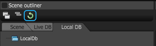

To update the local DB content click the Refresh button (Figure 3).
Local DB Update
Figure 3: Refresh button
