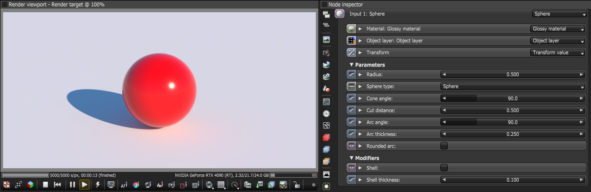

The Vectron® Sphere primitive creates a spherically shaped Vectron object (figure 1).
Sphere Primitive
Figure 1: The Sphere Vectron object
