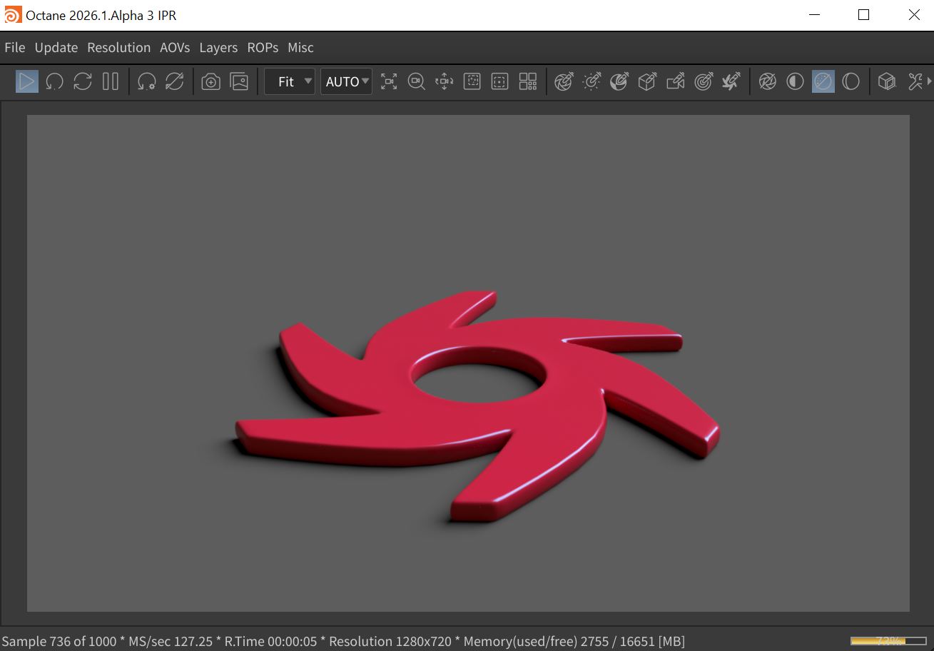

The Directional light functions as an infinite-distance light source and creates an effect much like the sun illuminating on the surface of the earth. Rotation is the only transform value that will affect this light type since it originates from an infinite location (figure 1).
Directional SPectron Light
Figure 1: The Directional Spectron light type
