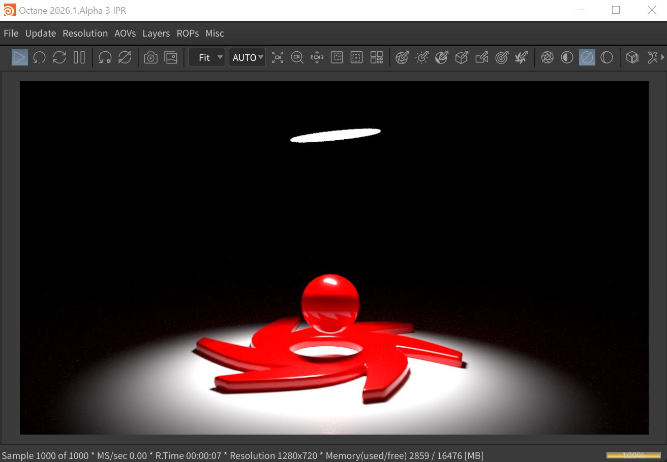

The Analytic light offer a fast approximation of direct light from large direct light sources on diffuse or glossy materials (figure 1). For every sample the complete contribution is estimated, taking into account the roughness of the material and the shape of the light source. There are four light types: Disk, Quad, Sphere, and Tube.
Analytic Light
Figure 1: The Disk Analytic light type
