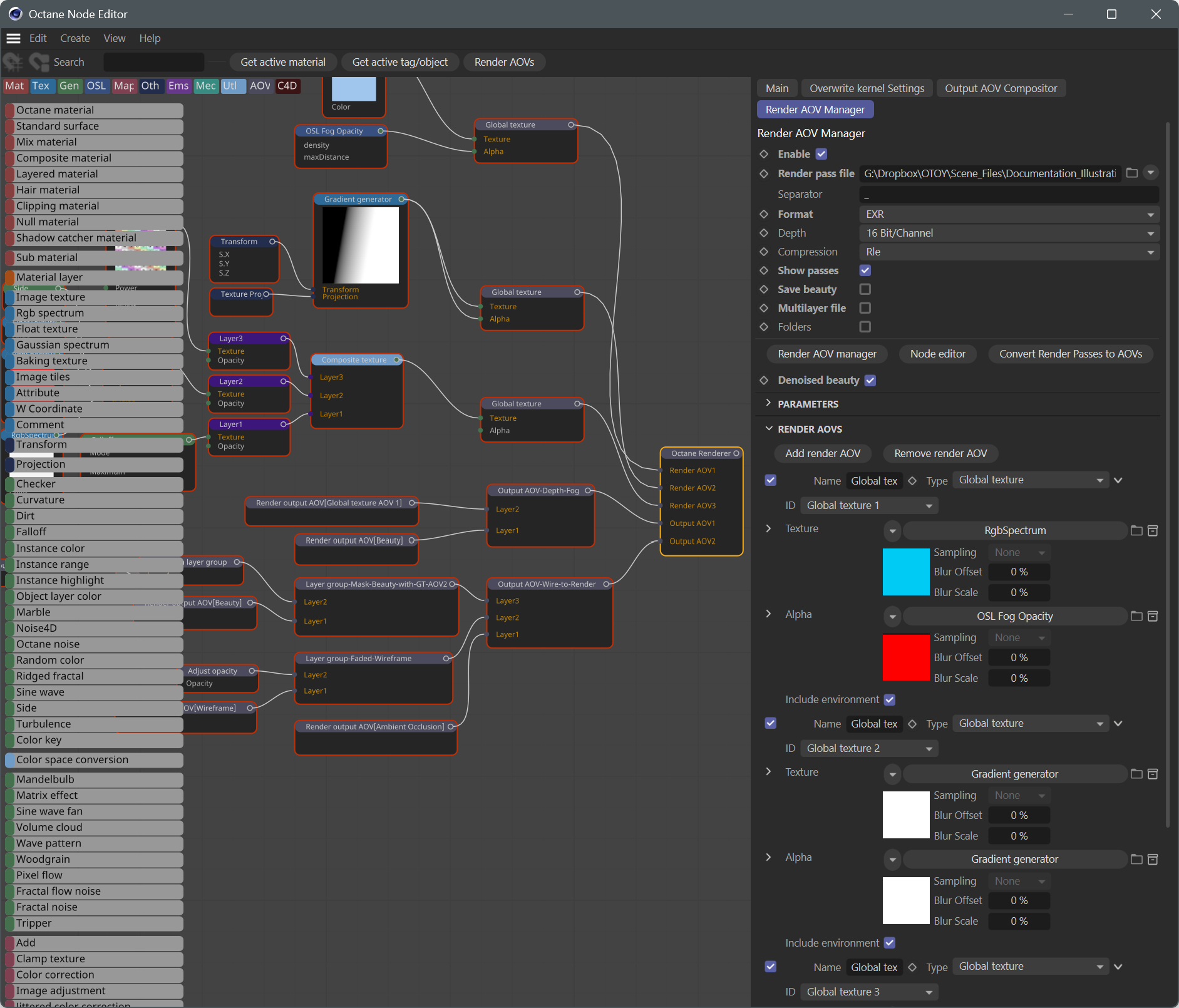

The AOV Compositing environment in OctaneRender offers real-time compositing of rendered output along with additional post-render output effects, such as color adjustments, brightness, blur, glows, and so on. The image below shows two such examples. The top image creates a blend from the wireframe output of the scene to the fully rendered version, using a gradient to mask between the two elements. The bottom image shows the real time addition of fog to the scene, determined by Z depth AOV.
The nodegraph below shows two example Output AOV composites and three Render AOVs, all feeding into the Octane Renderer node. The resulting output of these AOVs can be seen in the Live Viewer (via the labeled tabs on the bottom of the Live Viewer window, when viewed from left to right). Output AOVs and AOVs can be added via buttons in Render Settings > Octane Renderer > Output AOV Compositor > Add Output AOV and Render Settings > Octane Renderer > Render AOV Manager > Render AOVs.
Texture and generator nodes from the scene are fed into Global Texture AOV nodes, which are then, via Render Output AOV nodes, used to build the layered composite by the Output AOV nodes.
Octane Renderer Node
For Render AOVs and Output AOV composites to be output at render time, respective AOV nodes must be connected to the Octane Renderer node, which has two bespoke inputs: Render AOV and Output AOV, discussed below. Multiple inputs for these two types are supported. Only one Octane Renderer node per scene is allowed.
The Octane Renderer node houses the contents of the Octane Renderer Render Settings panel, inclusive of the Main tab, Overwrite Kernel Settings tab, Output AOV Compositor tab and the Render AOV Manager tab. For AOV work, the Output AOV Compositor tab and the Render AOV Manager tab contain the necessary controls, and offer access to the AOV Node Editor. The Octane Renderer node combines portions of the Render AOV Manager, the AOV groups and the Render Target node found in Octane Standalone. These nodes are not one-to-one matches for their Octane Standalone counterparts, as some of the functions in those nodes are offered within the Cinema 4D Render Settings Output panel and the Camera Attributes Details panel — something that Octane Standalone cannot leverage. Everything else is contained within this node.

The output of the Octane Renderer node is viewable in Live Viewer, via the buttons labeled "Out (number)" that appear when Render AOVs are enabled in the Render Settings > Octane Renderer > Render AOV Manager tab and Composite AOVs are enabled in the Output AOV Compositor tab.

The Octane AOV Node Editor (seen in the illustration below) is used to build compositing networks that can then be rendered out in addition to standard Octane renders, either as separate files or as layers within some formats, such as EXR(Octane). The AOV node editor is the same node editor that Octane uses for materials; that said, it is best to keep the AOV nodegraph separate from any material nodegraphs in the scene for readability and maintenance purposes.
The AOV node editor is accessed via Render Settings > Octane Renderer > Render AOV Manager tab > Node Editor button (an AOV system button is available at the top of the Octane Node Editor workspace to allow for easy context switching). A traditional Cinema 4D layered style representation of the AOV environment is also presented in the AOV Groups tab.

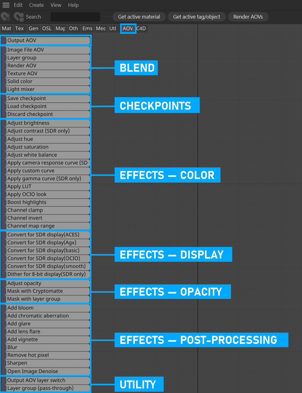

All of the non-legacy AOV nodes are available in the AOV Group in the Node Editor, as shown in the image below, broken down into categories of function.

The Texture Group Filter Buttons at the top left of the Node Editor work area can be used to control what Texture Groups are displayed in the Node Editor at any given time.
