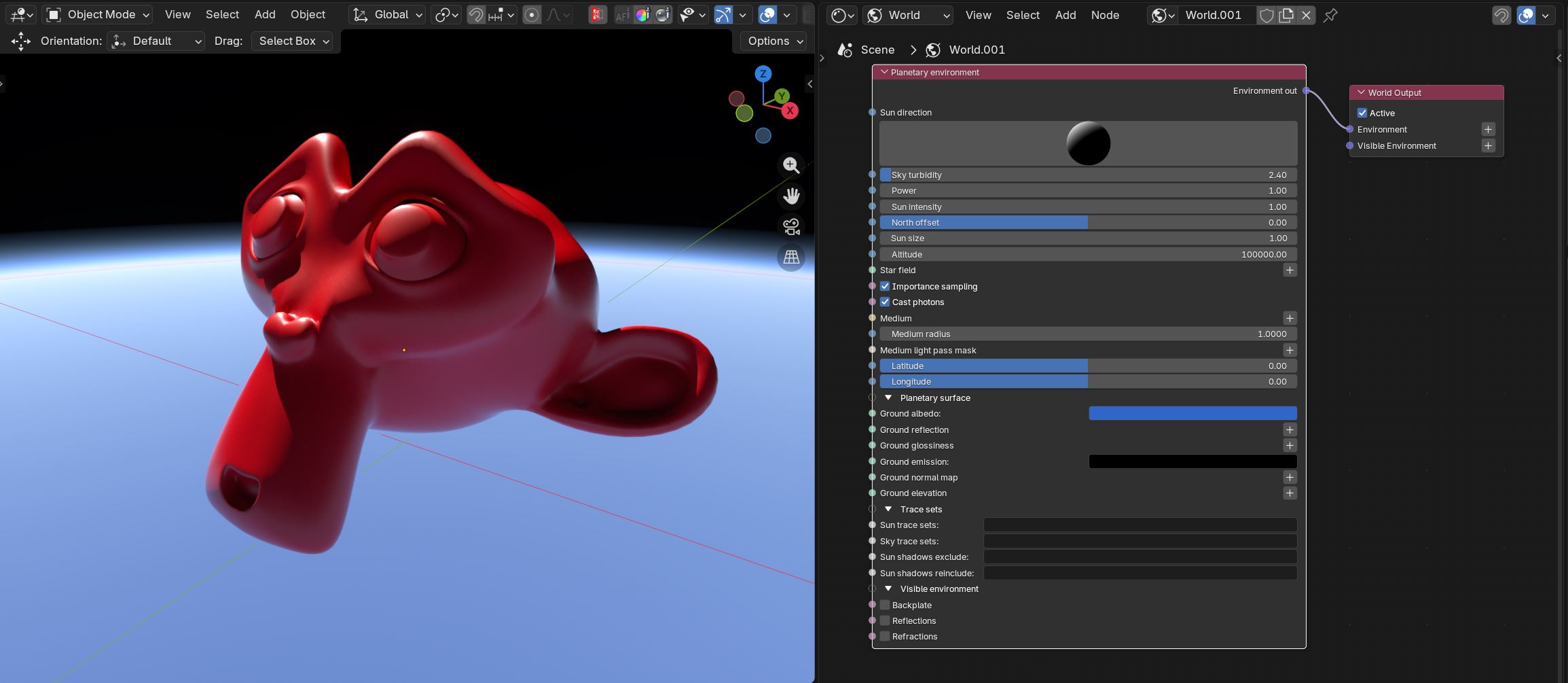

Figure 1: An object rendered at a Camera altitude of 100,000
This environment is not connected to the camera, so you can zoom the camera in and out of the scene without affecting the environment's position in the scene. It gathers optical depth (transmittance) from the sun position, so if the sun position is greater than 0.0f on the Y-axis (upward direction), then it will be colored. If you put it below the horizon (less than 0.0f on the T-axis), then it won't gather transmittance, making it invisible.
You can access the Planetary environment from the World tab, and the settings are located in the Environment rollout.  Alternatively, you can also view the node setup in the Shader Editor with Shader Type set to World instead of Object.

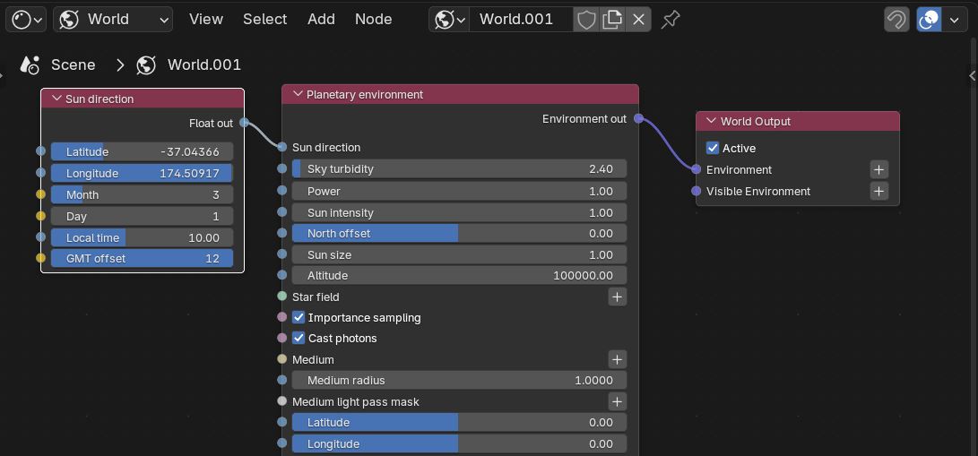

Sun Direction - By default, you can edit the sun direction by clicking and dragging on the Sphere icon. If a Sun Direction node is connected to the Daylight environment (figure 2), the Sphere icon will not be available and the sun direction is controlled by Latitude, Longitude, Month, Day, Local Time, and GMT Offset.
Sun Direction
Figure 2: The Sun Direction node
