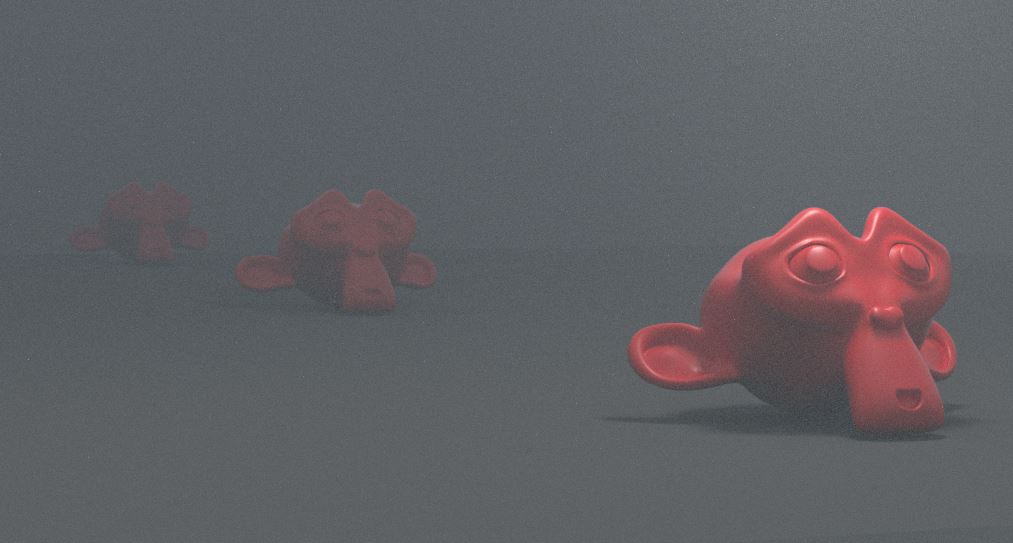

VBD Fog
Figure 4: An imported VDB used for environmental fog
