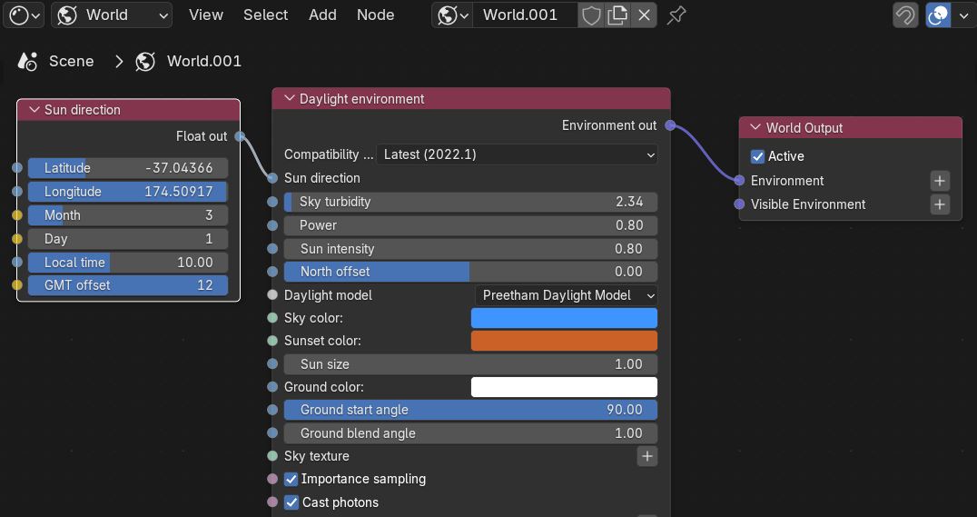

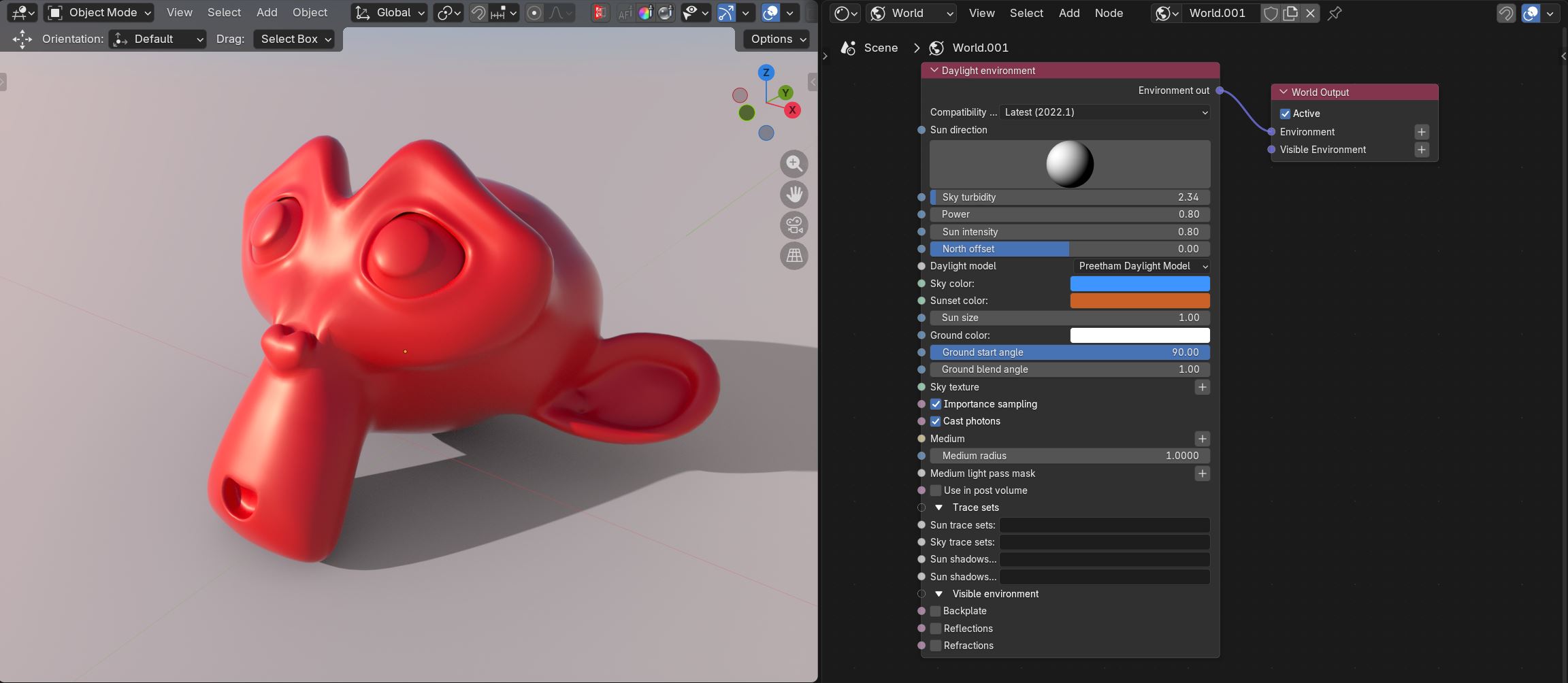

OctaneRender® has a powerful Daylight environment system to simulate real-world illumination that consists of a primary light (sun), indirect light (sky/environment), and an atmosphere (figure 1).
Daylight Environment
Figure 1: Daylight environment illuniating a scene
You can access the Daylight environment from the World tab, and the settings are located in the Environment rollout.  Alternatively, you can also view the node setup in the Shader Editor with Shader Type set to World instead of Object.
Daylight Environment Parameters
Sun Direction - By default, you can edit the sun direction by clicking and dragging on the Sphere icon. If a Sun Direction node is connected to the Daylight environment (figure 2), the Sphere icon will not be available and the sun direction is controlled by Latitude, Longitude, Month, Day, Local Time, and GMT Offset.
Sun Direction
Figure 2: The Sun Direction node
