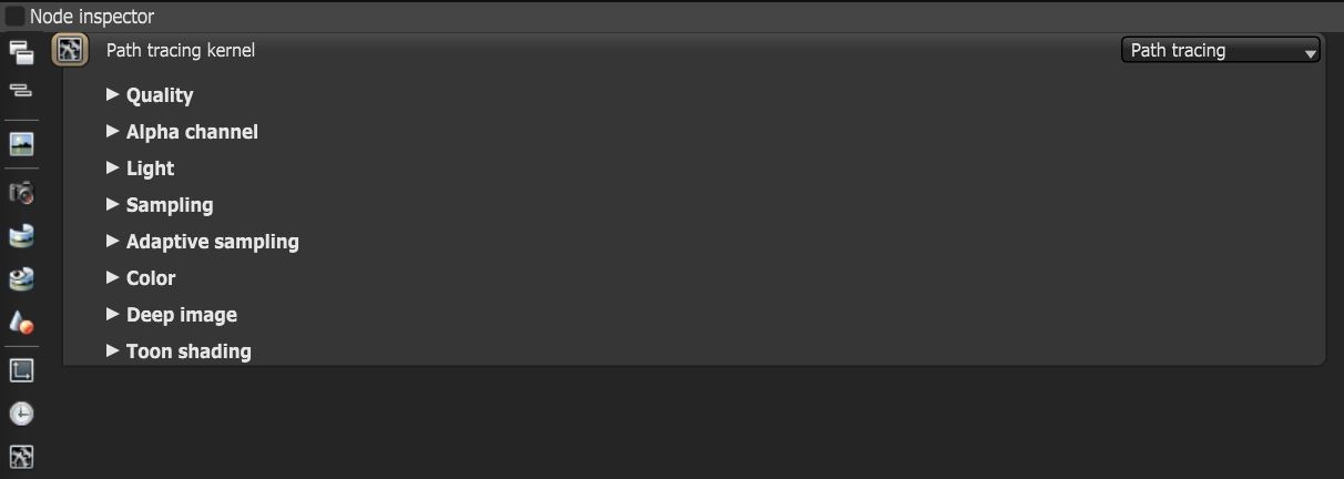

The Path Tracing kernel is a better choice for rendering photorealistic images than the Direct Lighting kernel. The increase in quality comes with the cost of increased render times. Path Tracing may have difficulty rendering scenes that use small light sources, and may not render proper caustics well. In these situations, the PMC render kernel is the better choice. Testing renders using each of the render kernels is the best way to determine what kernel is the best choice for a given scene. The parameters are group into eight categories (figure 1).
Path Tracing
Figure 1: Path Tracing settings in the Node Inspector

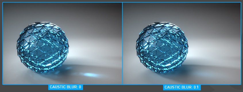

Caustic Blur - Reduces noise in caustic light patterns. High values result in soft caustic patterns (Figure 2).
Caustic Blur
Figure 2: Caustic Blur comparisons
