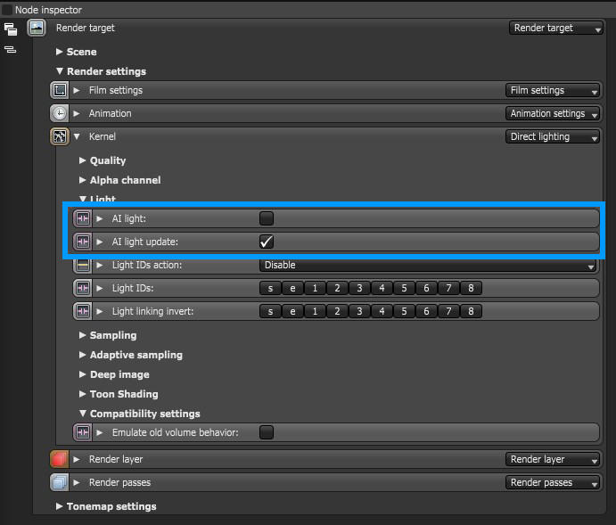

Figure 1: AI Light controls are accessed from the Kernel settings' Light section

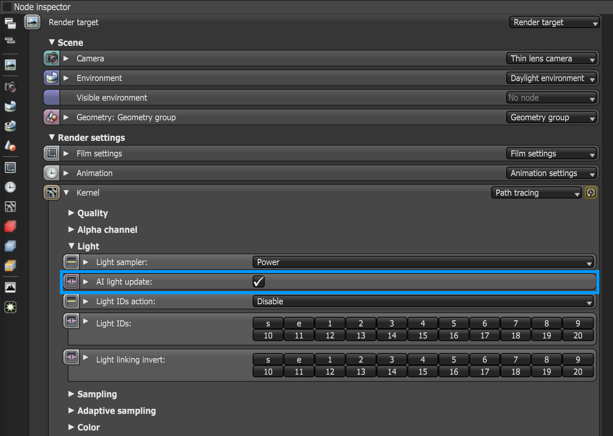

AI Light Update - Enables dynamic AI light update, which adaptively updates the light selection in direct light sampling, to help learn the current scene and where the lights are in that scene. For example, in cases where there is a wall occluding the light (the light has no effect in the given camera angle or position), AI Light Update understands that it does not need to sample this light.
NOTE Scenes rendered using versions 3.x.x and earlier will not have AI light attributes. These attributes will need to be explicitly set in the Kernel settings when the scenes are opened in Octane by enabling AI Light update. |
