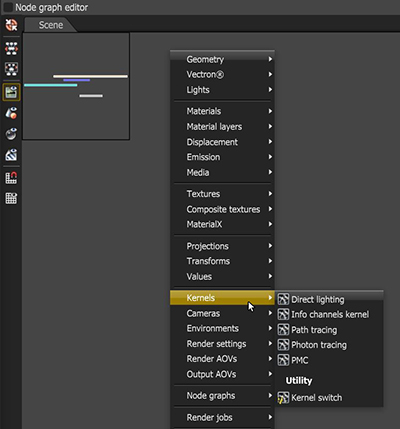

The Kernel nodes can be accessed by right-clicking in the Node Graph Editor and choosing the Kernels category (figure 3).There is a Kernel Switch node under the Utility section. This can be used to switch between different kernel types assigned to one Render Target node.
Accessing KErnel Nodes
Figure 3: Add a Render Kernel node from the Node Graph Editor
