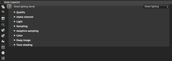

The Direct Light kernel is used for faster preview rendering. Direct Lighting is not unbiased and will not yield photorealistic results, but because of its speed, it is ideal for rendering animations or stills, depending on the project's demands. The parameters are group into eight categories (figure 1).
Direct Lighting KErnel
Figure 1: The Direct Lighting parameter categories in the Node Inspector

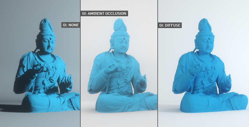

Global Illumination Mode - There are three types of global illumination modes available for the kernel (figure 2).
  • None - Includes direct lighting from the sun or area lights. Shadowed areas receive no contribution, and will be black.
  • Ambient Occlusion - Standard ambient occlusion. This mode provides realistic images, but offers no color bleeding.
  • Diffuse - This gives a GI quality that is in between Ambient Occlusion and Path Tracing, but without caustics. The advantage is much faster rendering than Path Tracing and PMC. It is similar in some ways to brute force indirect GI in other engines.
GI Mode
Figure 2: Global Illumination mode comparisons

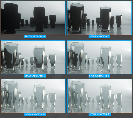

Specular Depth - Controls how many times a ray is refracted after hit the surface without losing its energy. A value of zero means that the ray does not hit the surface and cannot continue on the path (reflect or refract). If the value is greater than zero, the ray continues on its way through the surface and refracts until it loses its energy. Higher numbers mean higher render times but more color bleeding and more details in transparent materials. Low numbers can introduce artifacts or turn some refractions into pure black. Figure 3 illustrates different specular depth results from a scene with multiple glass objects.
Specular Depth
Figure 3: A comparison of renderings using different Specular Depth settings

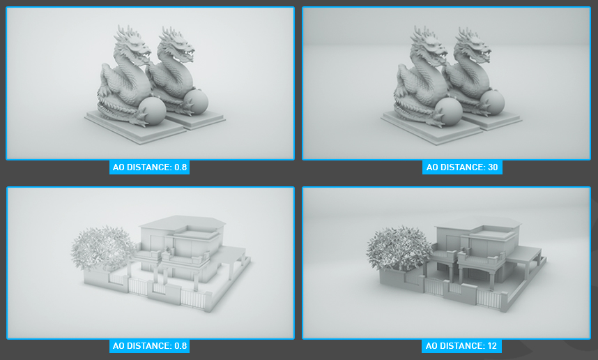

AO Distance - The distance of the ambient occlusion shadowing spread in units. This setting provides realistic results, depending on the scale of the objects in the scene. Small values are more appropriate for small objects like toys, and larger values are more appropriate for something like a house (Figure 4).
AO Distance
Figure 4: AO Distance settings comparison
