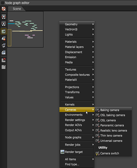

Camera nodes are also accessible by right-clicking in the Nodegraph Editor and choosing Cameras (figure3). These nodes can then be connected to the Camera pin of a Render Target node.
Node Graph Editor
Figure 3: Use the pop-up menu to add Camera nodes
There are seven types of camera nodes available for adjusting the camera settings: Thin Lens Camera, Panoramic Camera, Baking Camera,Realistic Lens Camera, two kinds of OSL Cameras and the Universal Camera.Additionally, there is a Camera Swtich node which allows for more than one camera to be connected to the Camera pin on a Render Target node.
