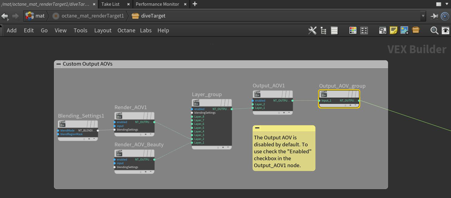

Output AOVs
Figure 1: Double-clicking to dive into a RenderTarget node

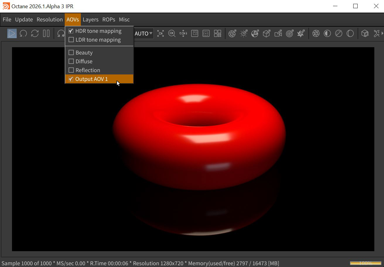

There is an Output AOV default system set up inside the RenderTarget node. After enabling the system in the Output AOV node, Render AOV nodes and Effects nodes can be added to the Layer Group node (figure 2).
Output AOVs
Figure 2: The Output AOV node results from figure 1

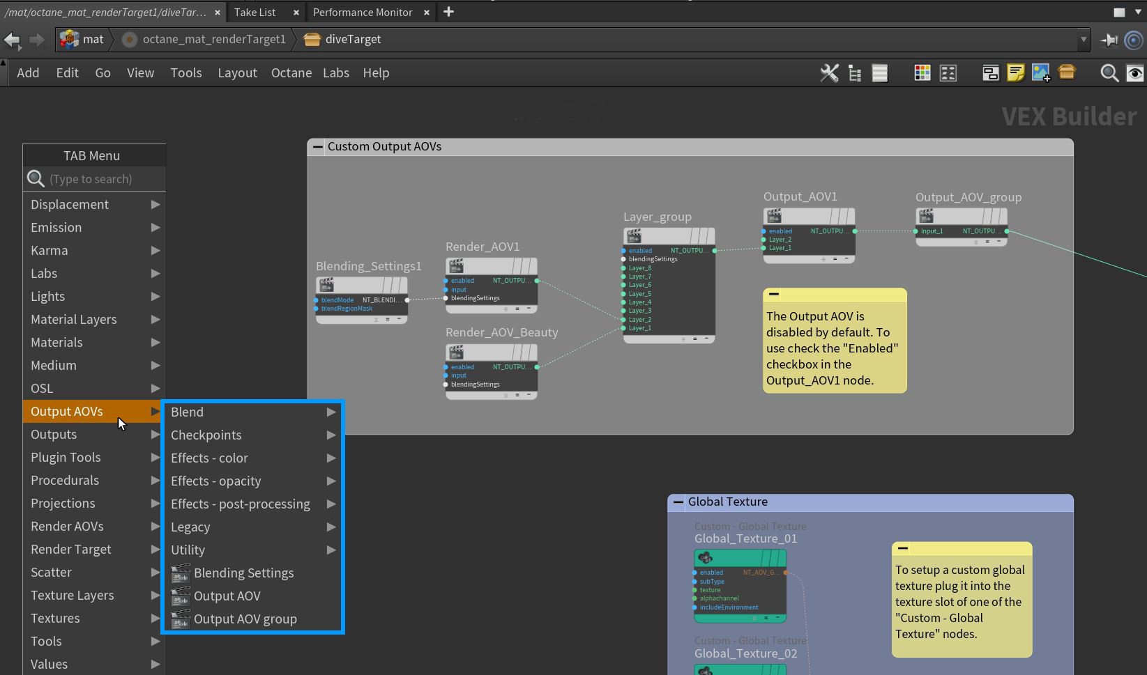

There are numerous categories of Output AOV nodes that can be access by right-clicking in the RenderTarget VEX Builder window (figure3). Details on the usage of these nodes can be found in the Octane Standalone documentation under the Output AOVs section.
Output AOVs
Figure 3: Accessing the Output AOV nodes
