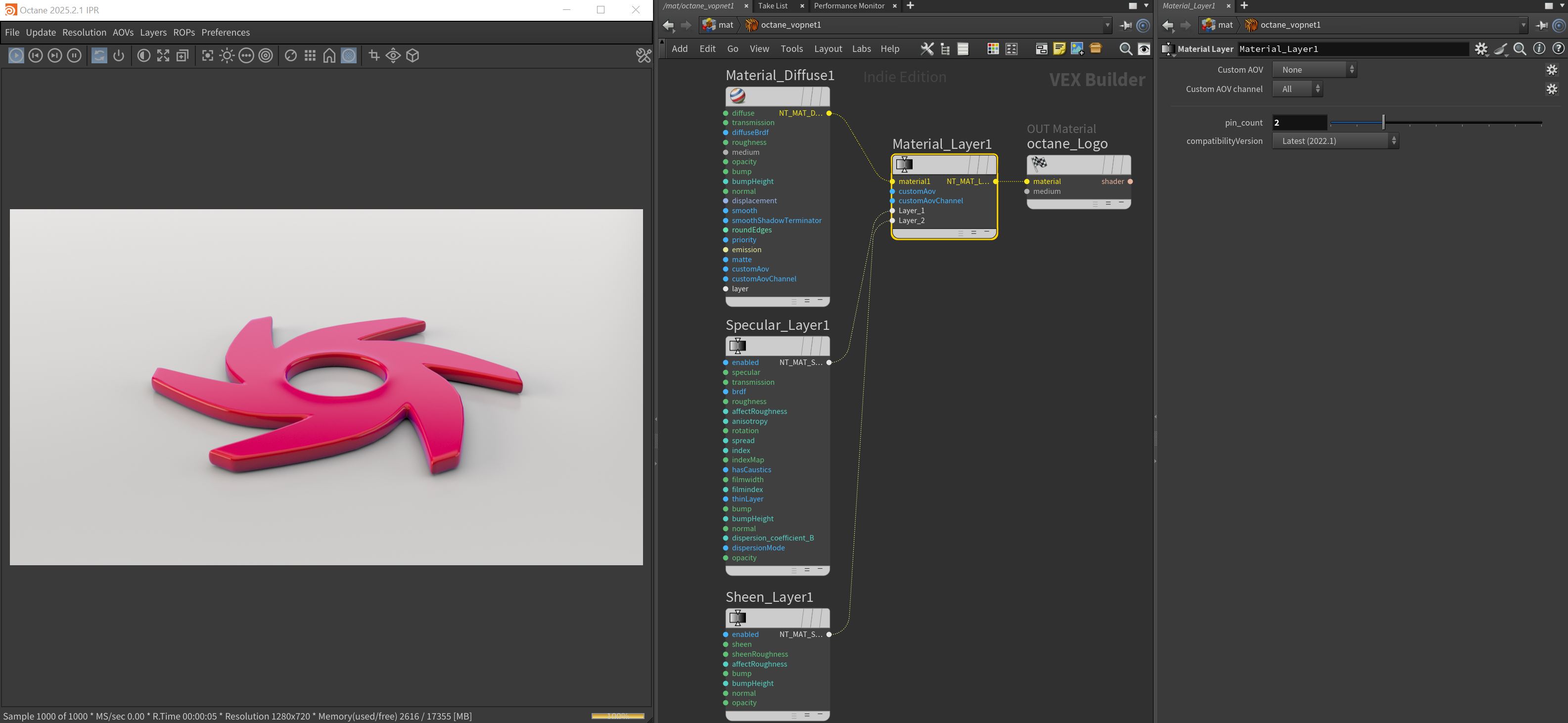

The Material Layer node constructs complex materials that consist of a base layer and up to eight material Layers (Figure 1). The Material Layer node can be connected directly to a Material OUT node (figure 1). Only a material can be connected to the Material pin and only Material Layers can be connected to the Layer pins. Additionally, a Material Layer Group node can connect to any of the Layer pins thus overcoming the eight Layer pin limit on the Material Layer node.
Material layer
Figure 1: The Layered Material with a Diffuse material as the Base Material and a Sheen and Specular Layer as the Layer Inputs
