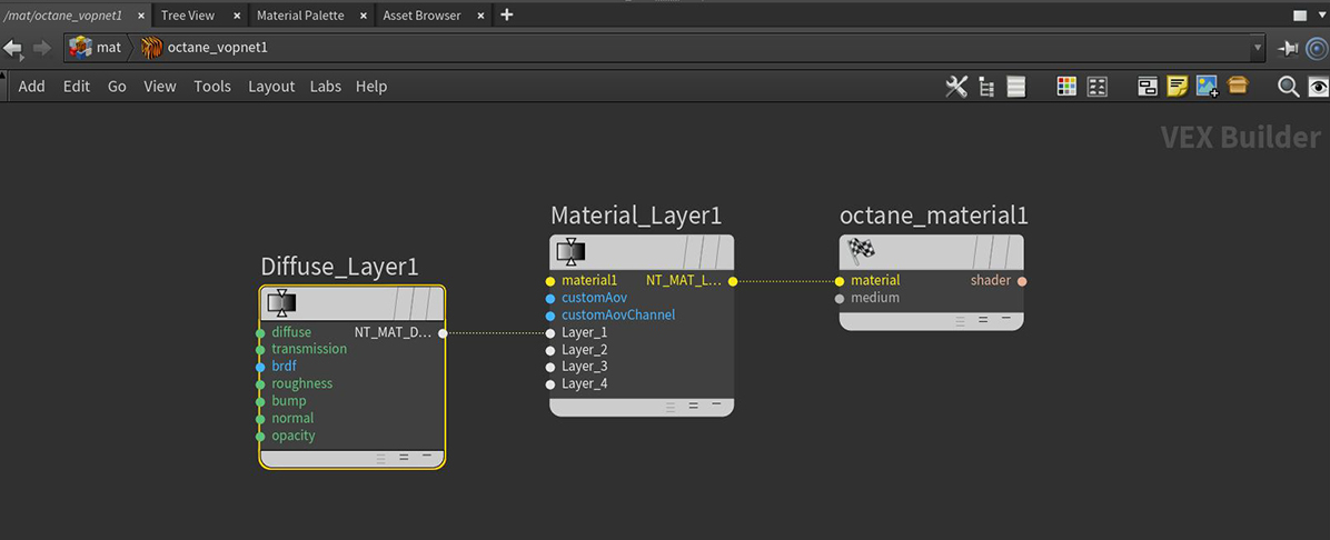

The Diffuse layer creates a dull, non-reflective surface.
Diffuse Layer
Figure 1: A Diffuse Layer node is connected to the Layer 1 pin on a Material Layer node
