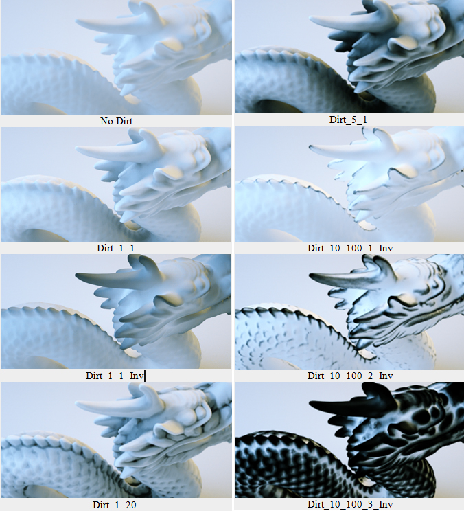

Dirt Texture
Figure 3: Dirt texture with various Strength, Details, Radius, and Invert settings
