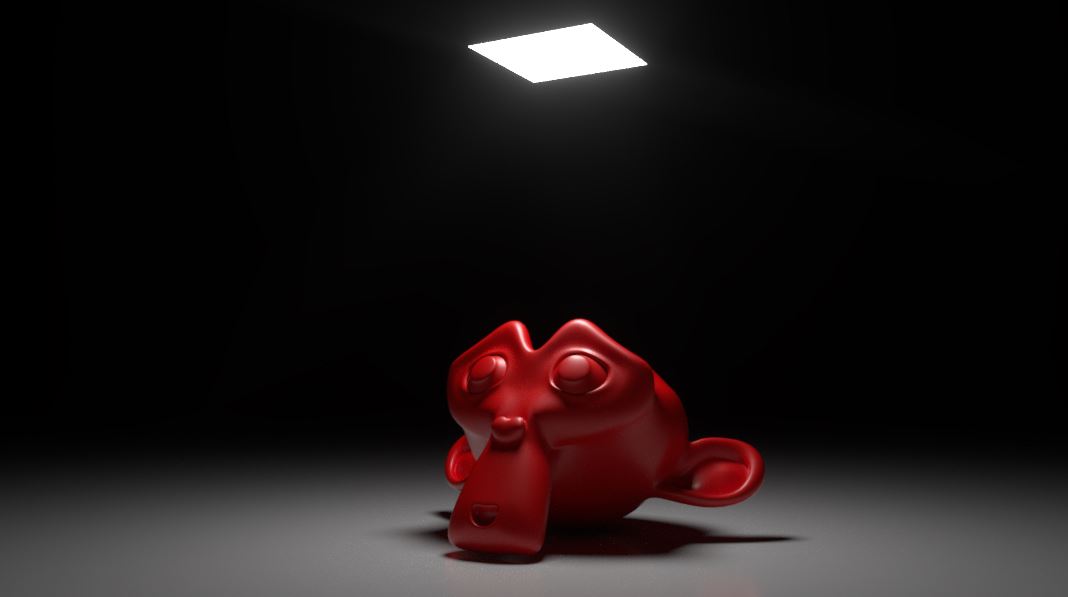

The Area Light is essentially a plane with a Diffuse material that has the Emission properties activated (Figure 2). The Area Light parameters can be access from the Shader Editor (Figure 2) or the Light Properties Panel (Figure 3).
Area Light
Figure 1: Area Light Example
