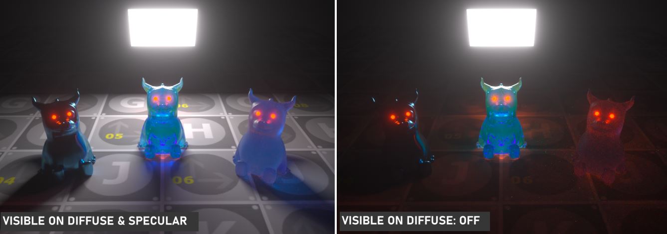

Visible On Diffuse - Enables light source visibility on diffuse surfaces. Black Body or Texture emission light sources can cast illumination or shadows on diffuse objects. Disabling this option disables emission - it's invisible in diffuse reflections, but is still visible on specular reflections. It's also excluded from the Direct light calculation. This option is enabled by default.
Visible on Diffuse
Figure 2: Visible On Diffuse enabled (left) and disabled (right)

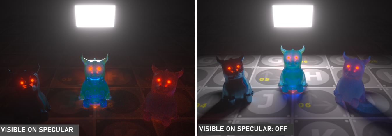

Visible On Specular - Enables the light source's visibility on specular surfaces, and hides emitters on specular reflections/refractions. This is enabled by default.
Visible on Specular
Figure 3: Visible On Specular enabled (left) and disabled (right)

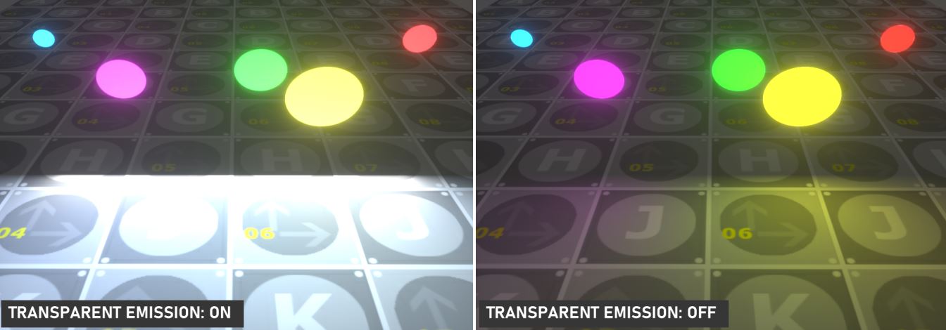

Transparent Emission - Light sources cast illuminations on diffuse objects, even if the light source is on transparent material.
Transparent Enabled
Figure 4: Transparent Emission enabled (left) and disabled (right)

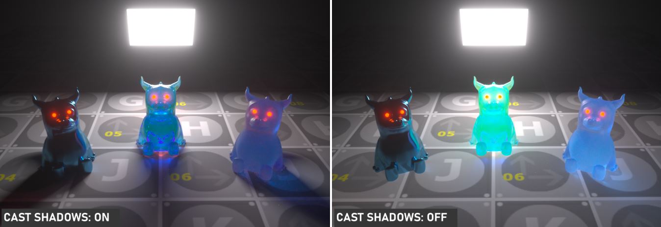

Cast Shadows - Enables light sources to cast light and shadows on diffuse surfaces, letting you disable direct light shadows for Mesh emitters. To make this option work, the Direct light calculation must include the emitter (the sampling rate must be greater than 0). This option is enabled by default.
Cast Shadows
Figure 5: Cast Shadows enabled (left) and disabled (right)
