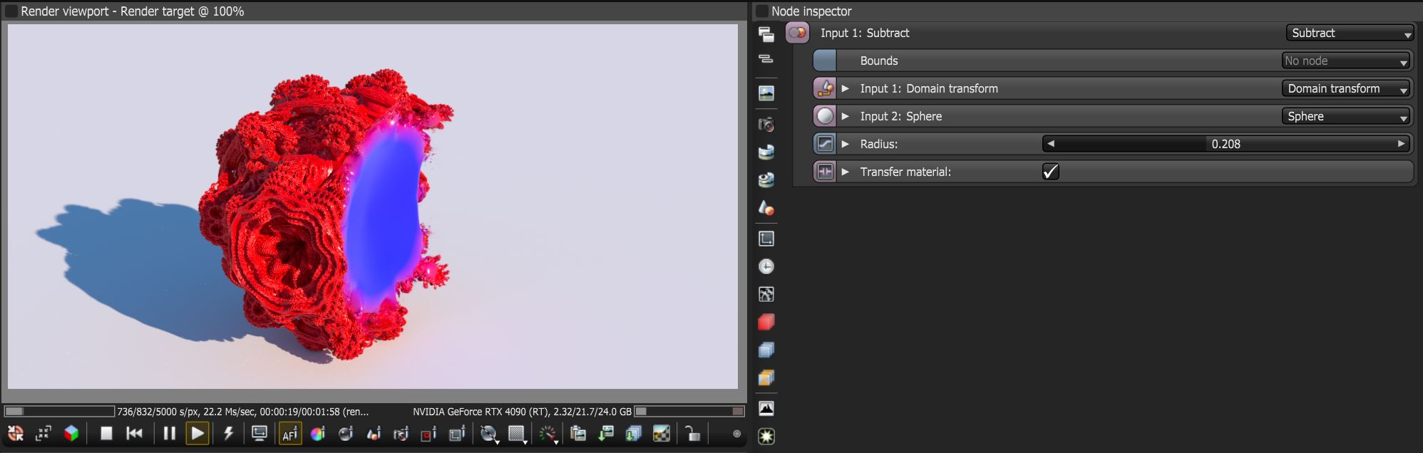

The Subtract Vectron® operator will output the subtraction of the second input from the first (figure 1).
SUBTRACT OPERATOR
Figure 1: A blue Vectron sphere being subtracted from a red Vectron OSL object
Subtract Parameters
Bounds - Determines the bounds of the Vectron geometry.
Input 1 - The base Vectron object.
Input 2 - The Vectron object that will subtracted from Input 1.
Radius - Increases the intersection area, higher values will produce smoother results.
Transfer Material - If enabled, the material on the second input will be kept on the intersecting results.
