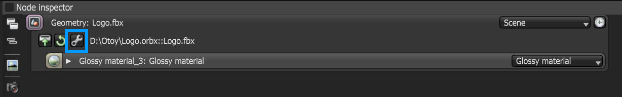

To determine how Octane renders meshes and scenes, you can adjust the settings in the Geometry Import tab of Preferences. You can also access the mesh settings by clicking on the Wrench icon in the Node Inspector when you select the mesh node (figure 1).
Import Preferences
Figure 1: Accessing the Import Preferences from the Node inspector
