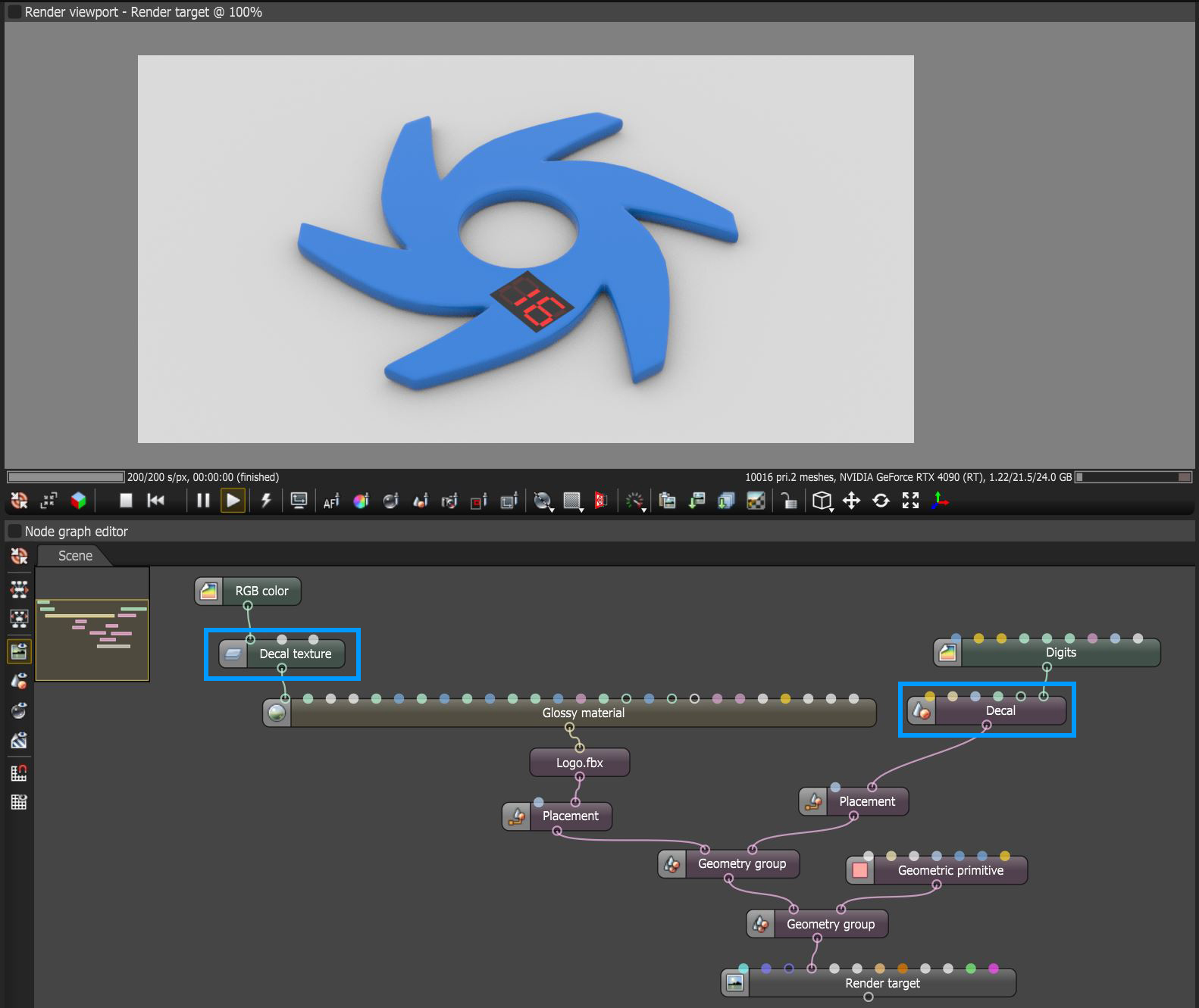

The Decal system is designed to allow for decals or stickers to be placed on scene objects. The system consists of the Decal node and the Decal Texture node. The Decal node can be found under the Geometry category in the Node Graph Editor window and the Decal Texture node can be found under the Textures category in the Node Graph Editor window.
The Decal Texture node is used between existing connected texture maps and texture map input pins on an Octane material. This node communicates with a Decal node connected to the host geometry via a Geometry Group node. Figure 1 illustrates how a basic decal system is set up in the Node Graph Editor window. A Placement node is used to allow for easier manipulation of the placement of the decal.
Decals
Figure 1: Using the Decal geometry node and the Decal texture node to add a decal to a scene object
