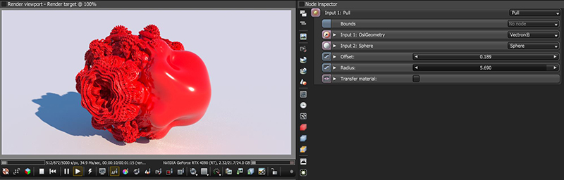

The Pull Vectron® operator used a Vectron shape to pull on the surface of another Vectron shape (figure 1).
Pull Operator
Figure 1: A sphere Vectron object pulinig a red Vectron object
Pull Parameters
Bounds - Determines the bounds of the Vectron geometry.
Input 1 - The base Vectron object.
Input 2 - The Vectron object that will pull Input 1.
Offset - Offsets the pull results from the pull surface's original volume.
Radius - Increases the intersection area, higher values will produce smoother results.
Transfer Material - If enabled, the material on the second input will be kept on the pull results.
