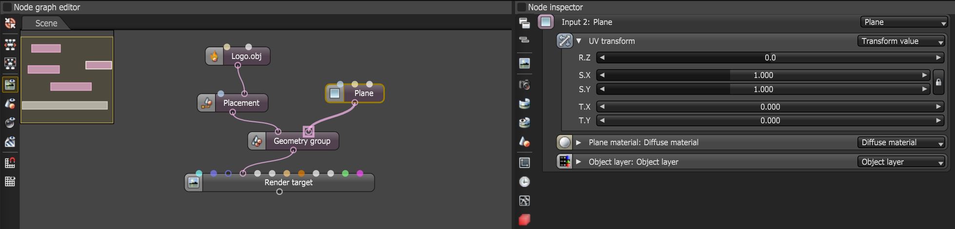

The Plane primitive is represented by the Plane geometry node, and can take a Material input (figure 2). You can add up to four infinite planes to a scene using the Plane geometry node. The UV mapping is aligned with the X/-Z coordinate axis, but you can also apply a transformation to the object using the Placement and Scatter nodes. Displacement mapping does not work on infinite planes.
plane node graph editor
Figure 2: Image of Plane node in the Nodegraph
