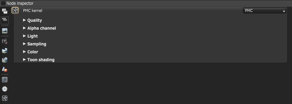

Figure 1: The PMC settings in the Node Inspector
PMC Kernel Parameters

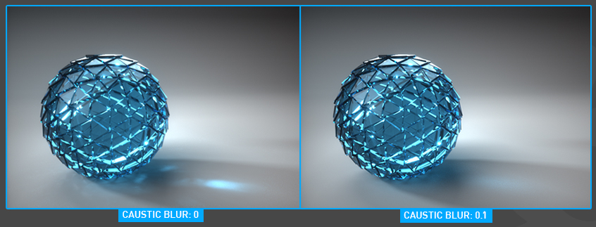

Caustic Blur - Reduces noise in caustic light patterns. High values result is softness in the caustic patterns (Figure 2).
Caustic Blur
Figure 2: Caustic Blur comparisons
