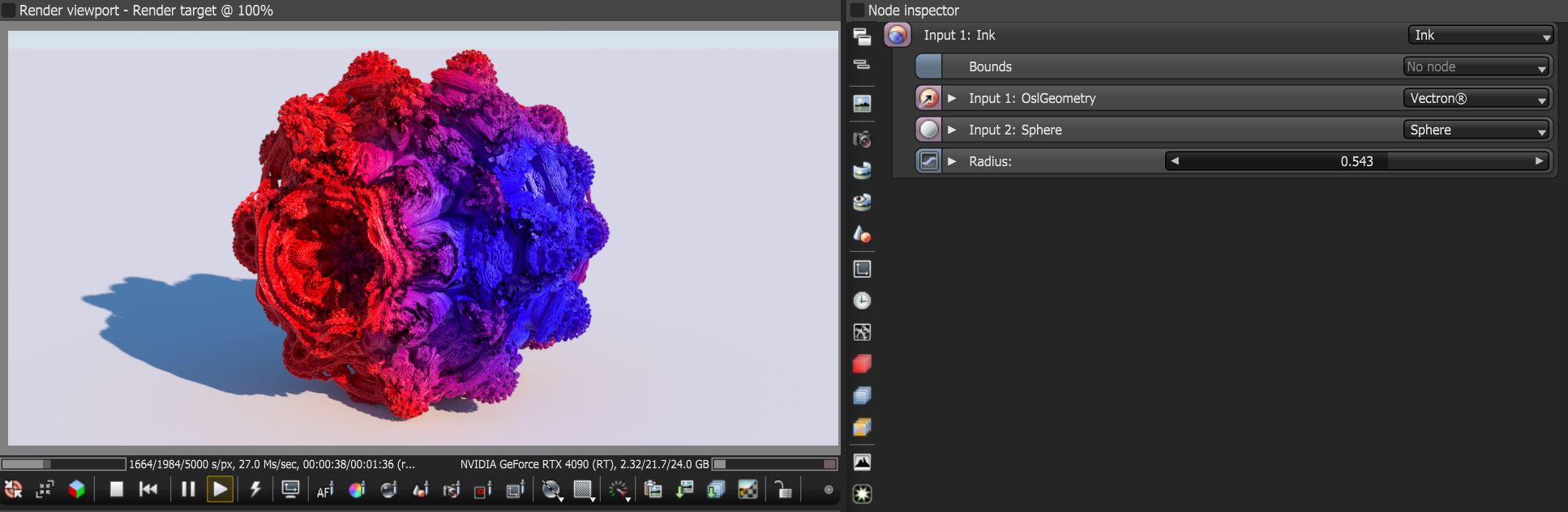

The Ink Vectron® operator will place the second input's material on the first input where the two Vectron objects intersect (figure 1). The Radius parameter will blur the transition between the two materials.
Ink OPERATOR
Figure 1: Results of blue Vectron sphere inking over a Vectron OSL object

Bounds - Bounds of the geometry in meters. If no node is connected, this is derived from the nodes connected to the input.
Input 1 - Material input 1.
Input 2 - Material input 2.
Radius - Blur the transition between the two materials.
