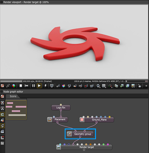

A Geometry Group nodes collates individual Geometry nodes to assemble a scene or parts of the scene (figure 1). This node can be found under Geometry > Utility in the Node Graph Editor window
geometry group
Figure 1: The Geometry Group node combines the logo with a ground plane
