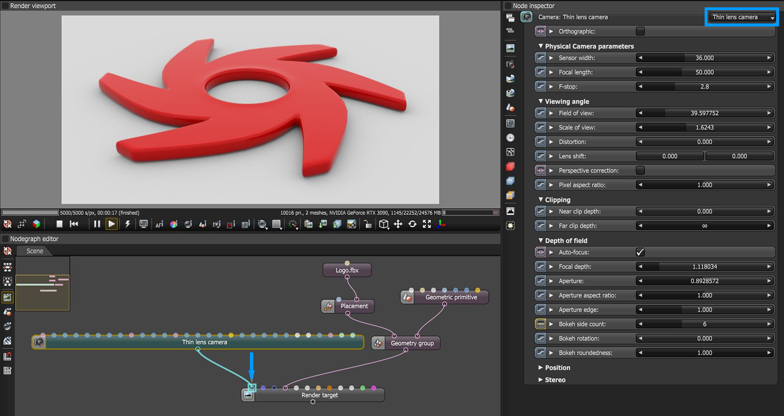

In OctaneRender®, a default camera is always present in a scene. Additionally, there are several different types of camera nodes that can be added to the Nodegraph Editor. The primary Camera node type is the Thin Lens Camera. Camera nodes are connected to the Camera input pin on a Render Target node (figure 1). There can be multiple camera nodes present in the Nodegraph Editor, allowing multiple camera locations to render a scene.
Thin Lens Camera
Figure 1: A Thin Lens Camera node is connected to the Camera input pin on a Render Target node
