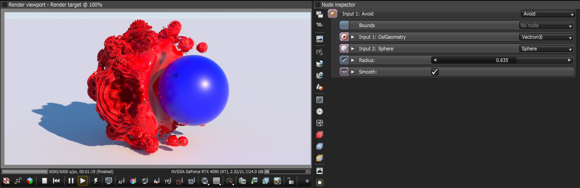

The Avoid Vectron® operator node makes one Vectron surface avoid another Vectron surface (figure 1).
Avoid Operator
Figure 1: A sphere used as an avoidance object
Avoid Parameters
Bounds - Bounds of the geometry in meters. If no node is connected, this is derived from the nodes connected to the input.
Input 1 - The base surface that avoids the second surface.
Input 2 - The surface that is avoided by the base surface.
Radius - The radius around input 2 where input 1 starts to avoid input 2.
Smooth - Smooths the deformation of the base surface.
