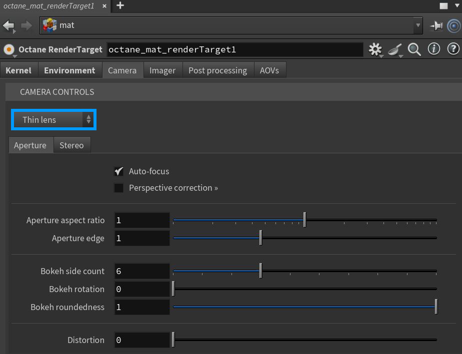

The Thin Lens camera is the typical camera type used for most rendering scenarios.When you select Thin Lens as the camera type in the Render Target's Camera tab, the following parameters are available (Figure 1).
Thin Lens
Figure 1: The Thin Lens camera parameters
Thin Lens Camera Parameters
Aperature Tab
Auto-Focus - If enabled, focus is kept on the closest visible surface at the center of the image, regardless of the Aperture, Aperture Edge, and Focal Depth values.
Perspective Correction - If the camera's up direction in the scene is vertical, enabling this option keeps vertical lines parallel.
Aperture Aspect Ratio - Squash or stretch the depth-of-field disc, effectively enhancing the depth of field blur with higher values.
Aperture Edge - This controls aperture edge detection at all points within the aperture. Lower values give more pronounced edges to out-of-focus objects affected by a shallow depth-of-field. Aperture Edge modifies the bokeh effect of the depth-of-field. High values increase the contrast towards the edge.
Bokeh Side Count - The number of edges that make up the bokeh shape.
Bokeh Rotation - The bokeh shape's orientation.
Bokeh Roundedness - Determines the roundness of the bokeh edges.
Distortion - This adjusts the spherical and cylindrical distortion. The rendered image displays the entire sphere and uses equidistant cylindrical projection.
