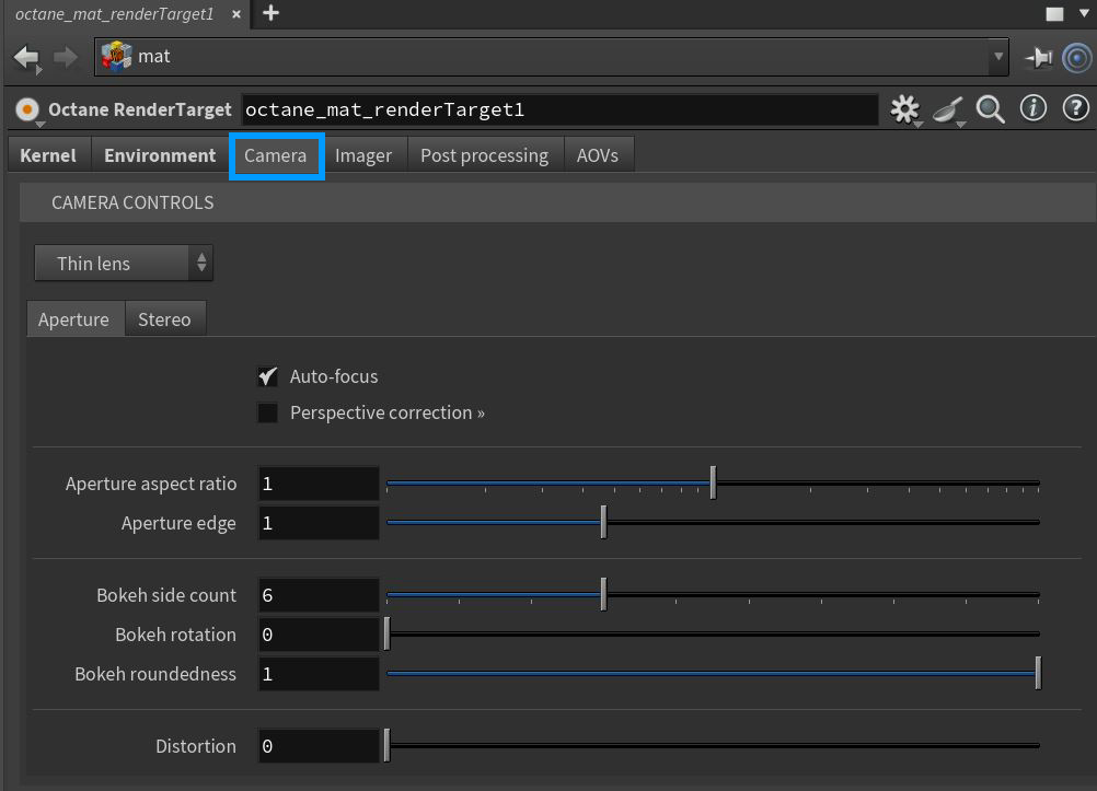

You can find additional camera parameters in the Octane Render Target node (Figure 1). These parameters vary, depending on what type of camera you select (Thin Lens, Panoramic, or Baking). The Thin Lens, Panoramic, and Baking parameters are covered in this article's sub-sections.
Camera Settings
Figure 1: Accessing the camera settings from the Octane Render Target node
