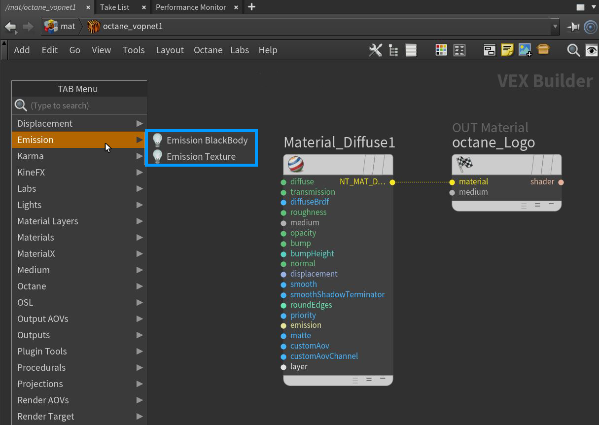

In order to create a Mesh Emitter as a light source, you need to apply a Diffuse, Universal, or Standard Surface material to the mesh. The material's Emission parameter offers two different options for creating light-emitting materials: BlackBody and Texture (Figure 1).
Mesh Emitter
Figure 1: Accessing the BlackBody and Texture mesh emitter types

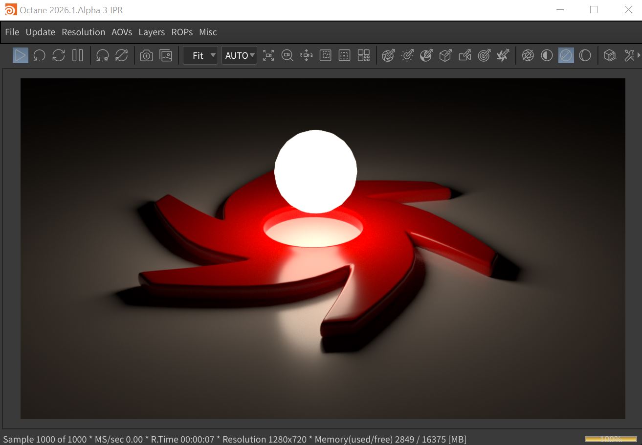

Mesh Emitter
Figure 2: A scene object used as a Mesh emitter
