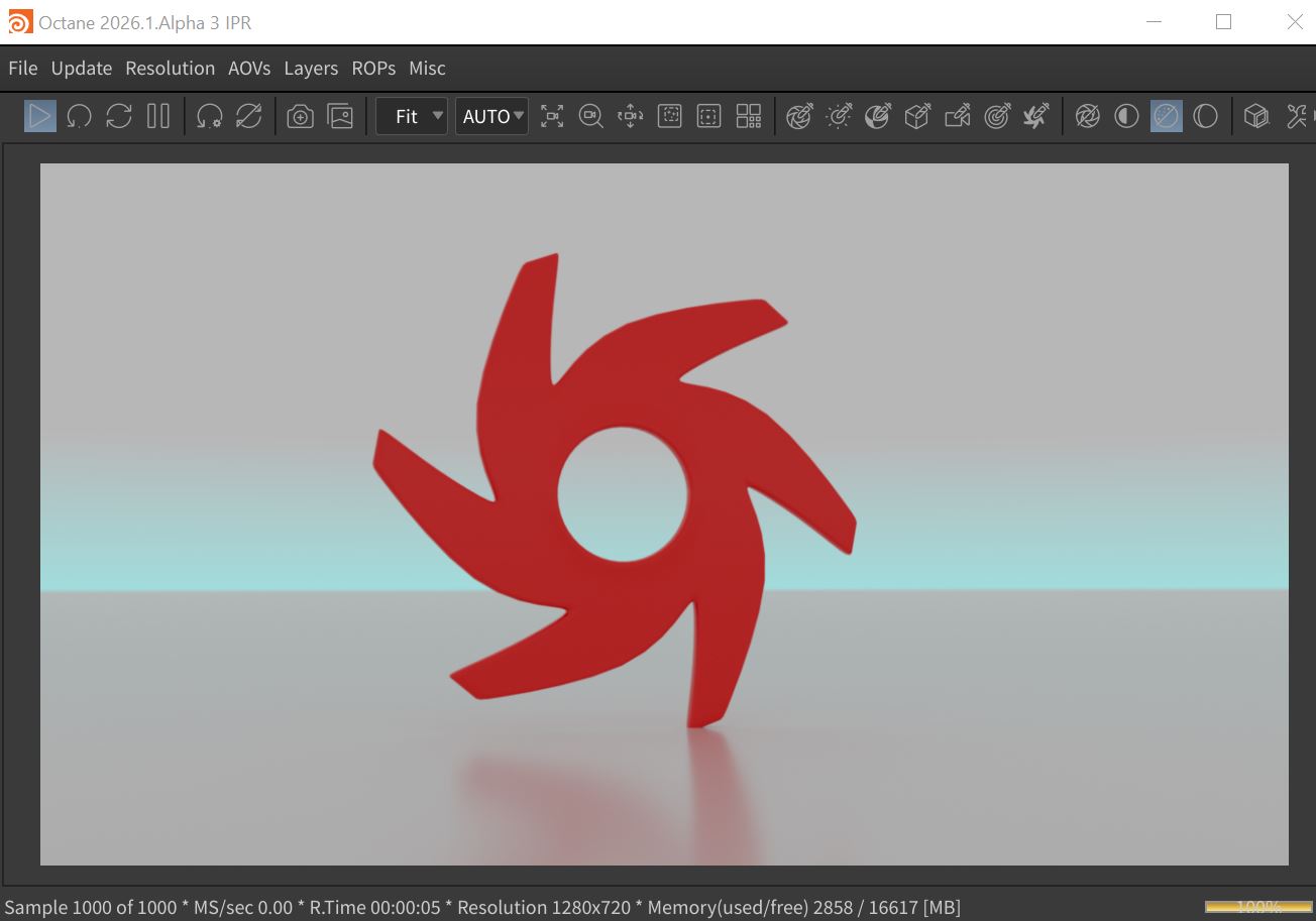

The Gradient environment creates lighting based on a gradient (figure 1).
Environment Gradient
Figure 1: A scene rendered using the Gradient environment

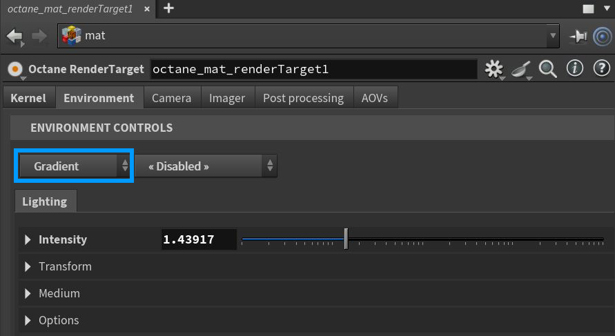

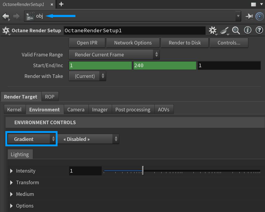

The Gradient system is found in the Environment tab of the Render Target parameters window (Figure 2). The Gradient system can also be found in the Octane Render Setup node located in the Object window (figure 3).
Figure 2: Accessing the Gradient environment node from an Octane Render Target.
Figure 3: Accessing the Gradient parameters in the Octane Render Setup node

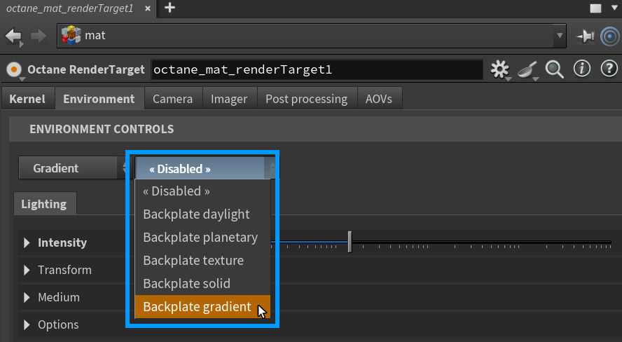

Parameters specific to the Gradient system are found in the Intensity, Transform, Medium, and Options rollouts.There is a Backplate tab available to further control the options for displaying backplate elements (figure 4). If the Backplate is set to anything other than Disabled, such as Backplate Gradient,  the Backplate parameters will override any duplicate background elements available in the Gradient tab. Note that the Backplate parameters do not affect the physical lighting on scene objects.
Environment Backplate
Figure 4: Accessing the Environment Backplate parameters
