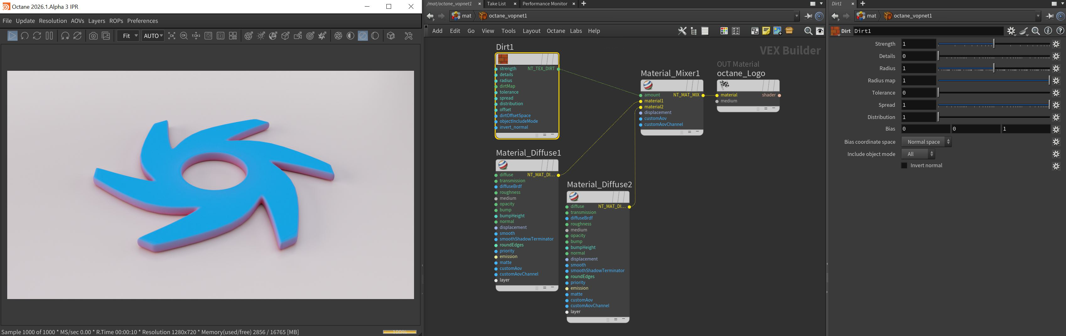

The Dirt node can create different effects based on ambient occlusion calculations (figure 1). This texture always returns a random value and can simulate dirt, dust, or wear-and-tear. The Dirt procedural is often plugged into the Diffuse, Bump, Transmission, or Amount parameters.
Dirt
Figure 1: The Dirt texture node applied to a scene object

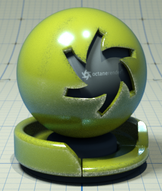

dirt
ProceduralDirt
Figure 2: The Dirt node mixed with two Glossy materials
