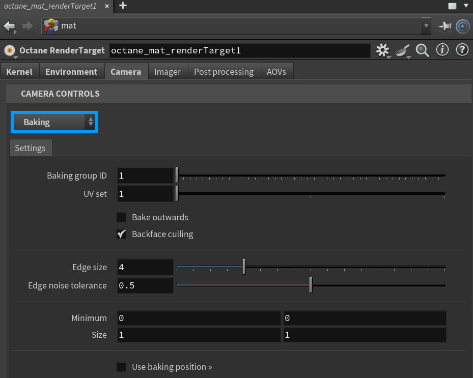

Using a scene that contains geometry, lighting, material information, etc., the easiest way to get started is to create a copy of your render camera and replace its Octane Camera Type with a Baking camera (Figure 1).
Baking
Figure 1: Setting the camera type to Baking
Baking Camera Parameters
Baking Group ID - Specifies the baking group to bake. By default, all objects belong to the default Baking Group number 1.
UV Set - Determines the set of UV coordinates to use.
Bake Outwards - If enabled, camera rays are flipped, which allows using the geometry as a lens.
Backface Culling - Determines whether or not to bake back facing geometry. This option is active by default.
Edge Size - Determines the number of pixels added to the UV map edges.
Edge Noise Tolerance - Determines the tolerance to keep or discard edge noise.
Minimum And Size - Specifies the area that the baking camera takes into account. You can pan and zoom in and out of the camera in case your UV geometry is not within the 0,0 - 1,1 region.
Use Baking Position - If you use a baking position, camera rays are traced from the specified coordinates in world space instead of using the Mesh surface as reference. This is useful when baking position-dependent artifacts such as Glossy or Specular materials.

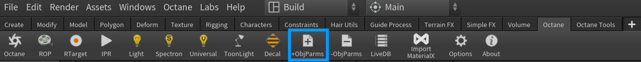

The baking group ID for scene objects is specified in the Octane Parameters tab. The Octane Parameters tab is not attached to a scene object by default. You must add it to an object by selecting the object and clicking the +ObjParms button in the Octane shelf (Figure 2).
Baking
Figure 2: Adding the Octane object parameters node to a scene object
