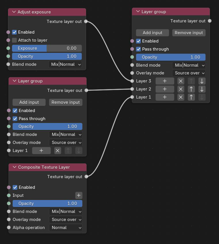

The Layer Group node is a traditional composite stack for combining mulitple texture layers (figure 1). The Layer Group nodes's Input socket will only accept Composite Texture Layer nodes, other Layer Group nodes, or any of the Composite Texture nodes (figure 3)
Layer Group
Figure 1: A Layer Group node used to combine Adjust Brightness and Composite Texture Layer Nodes
Layer Group
Figure 2: Nodes accepted by the Layer Group node
