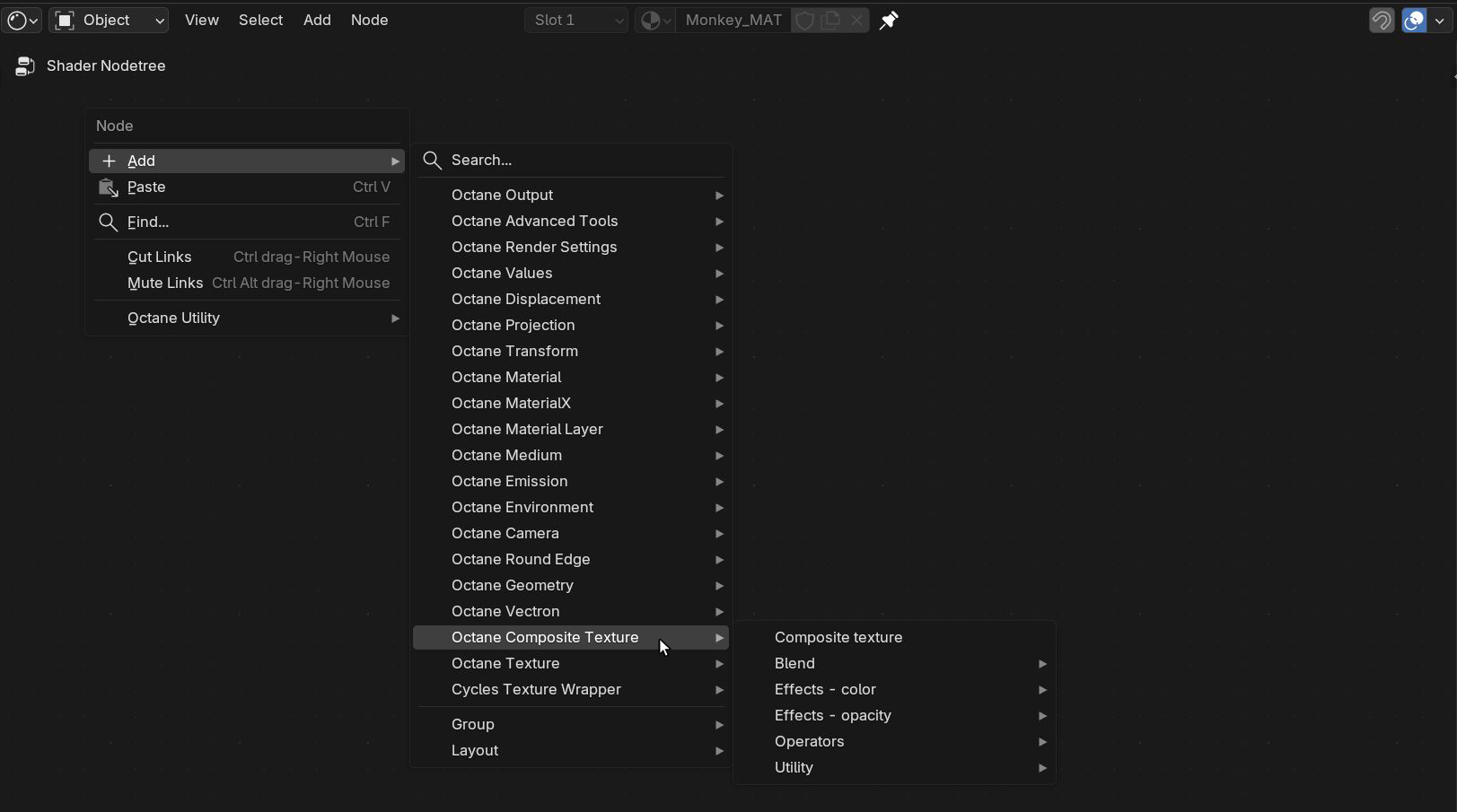

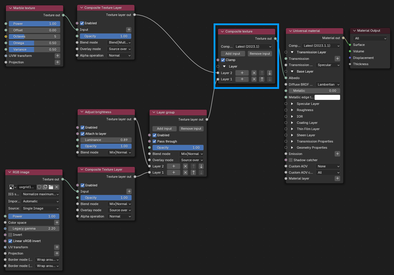

The Octane Composite Texture nodes allow for a composite stack to combine textures with various effects. These nodes are used with Composite Texture node which connects to input sockets on Octane material nodes (Figure 2).
Composite Texture
Figure 1: Octane Texture Layer Node List

Figure 2: Composite Texture Node is used to combine multiple Texture Layer Nodes before feeding to a Universal Material Albedo pin
NOTE Only Octane Composite Texture nodes can be connected to the Composite Texture node. Texture nodes found under the Octane Texture category must be connected to a Composite Texture Layer node. |
