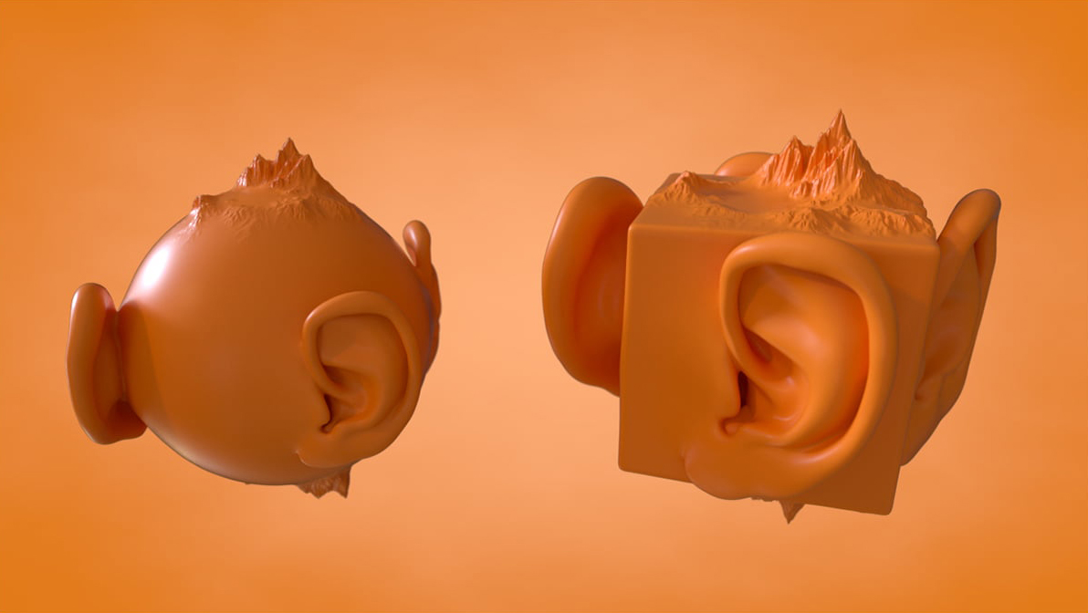

The Vertex Displacement Mixer allows you to mix multiple Vertex Displacement nodes. In figure 1. triplanar mapping is used to apply multiple displacement maps to surfaces. A terrain displacement map is used for the Y+/- areas of the meshes and then the ear vector displacement for the X+/-, Z+/- directions.

Figure 1: Vertex Displacement Mixer examples
