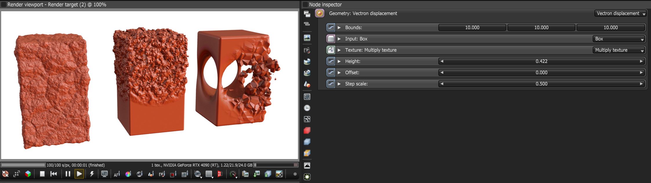

The Vectron Displacement node displaces a Vectron® or a Volume SDF with an input texture. It functions in real time, at any scale, and is compatible with complex SDF trees or Mesh Volume SDF nodes. A field texture can be used to limit the area of action (figure 1).
Figure 1: Examples of Vectron Displacement
