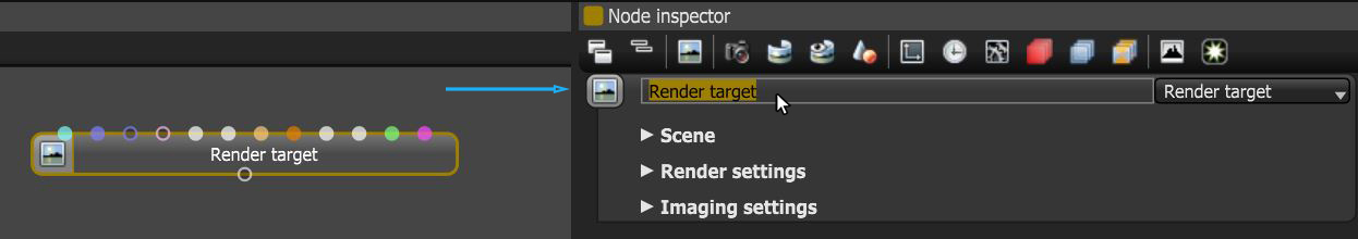

The Node Inspector (Figure 1) provides access to nearly every aspect of the render/scene in OctaneRender. Nodes that are selected in the Node Graph Editor window are displayed in the Node Inspector where their values can be adjusted or changed. For example, when using the Material Picker, the selected material will also be displayed in the Node Inspector window.
node inspector
Figure 1: A Render Target node's input pin correspond to the attribute list in the Node Inspector.

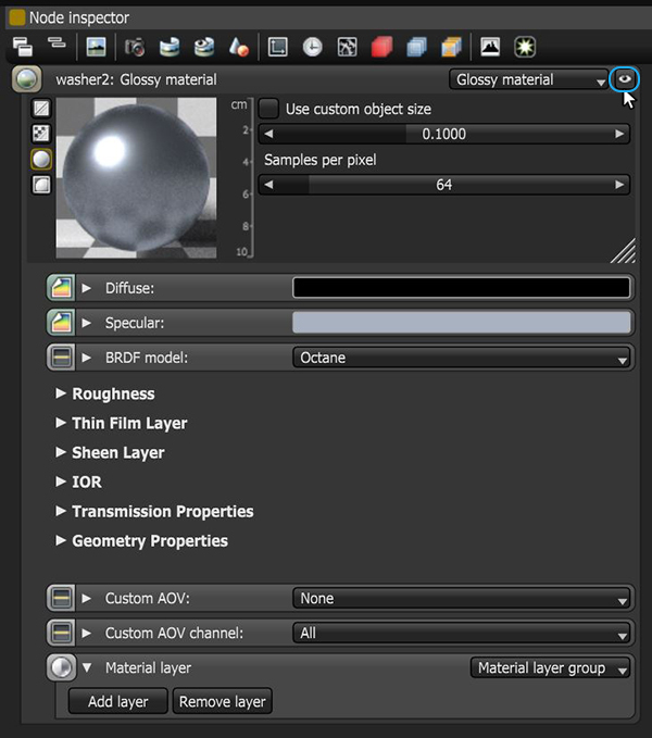

Quick Material Previews
It is possible to enable quick previews of materials and textures inside the Node Inspector window (Figure 5). These are rendered without interrupting the main render, and OctaneRender updates them when the material or texture changes. A material can be previewed on a sphere or a flat 2D image.
Previewing Material
Figure 5: Preview button
