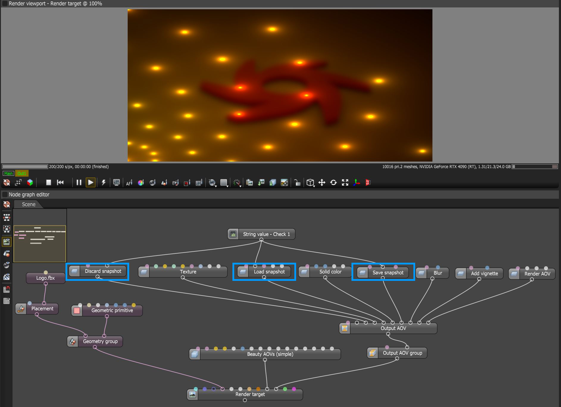

The Snapshot nodes are used to save a point in a compositing node tree that can be recalled further up the compositing stack. These are essentially the Checkpoint system from previous versions of Octane renamed. In figure 1, a snapshot is saved before the Solid Color node. The snapshot is then loaded after the Solid Color node, thus skipping the color overlay created by the Solid Color node. A Texture node is then applied and the snapshot is discarded to save GPU memory once the snapshot is no longer needed.

Figure 1: A basic compositing node tree illustrating the usage of the Snapshot nodes
