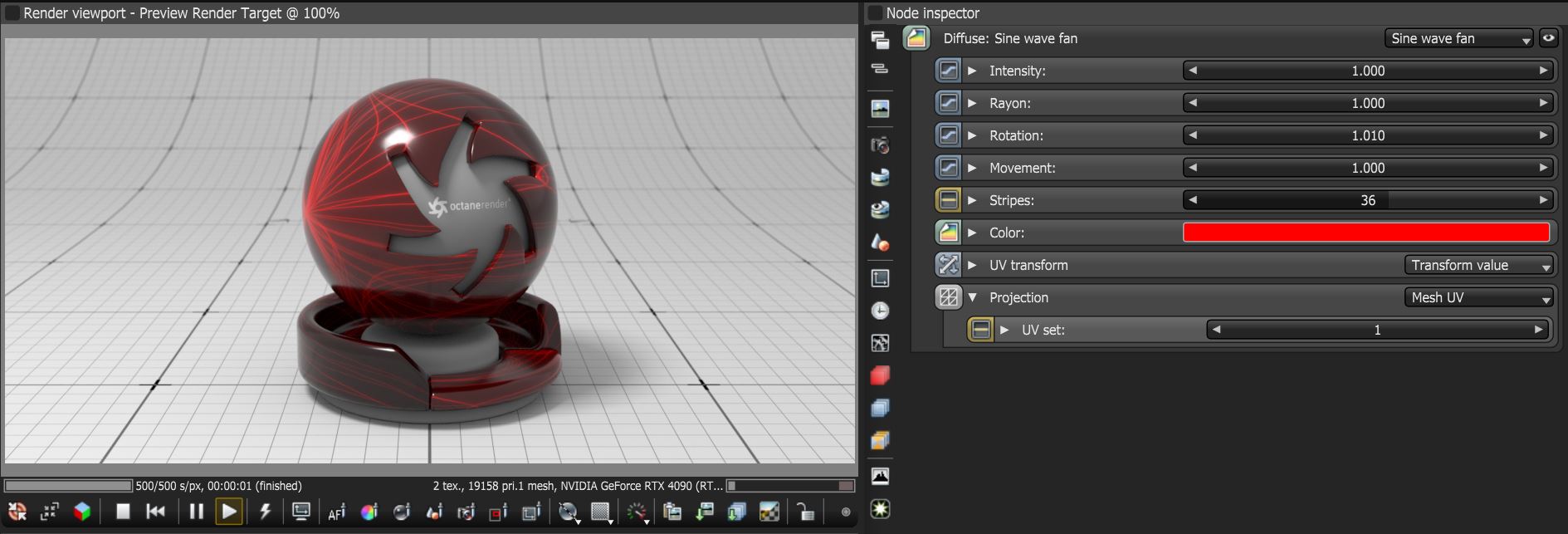

The Sine Wave Fan procedural texture produces an overlapping pattern based on a Sine wave (figure 1).
Sine Wave Fan
Figure 1: The Sine Wave Fan node and it's associated parameters
