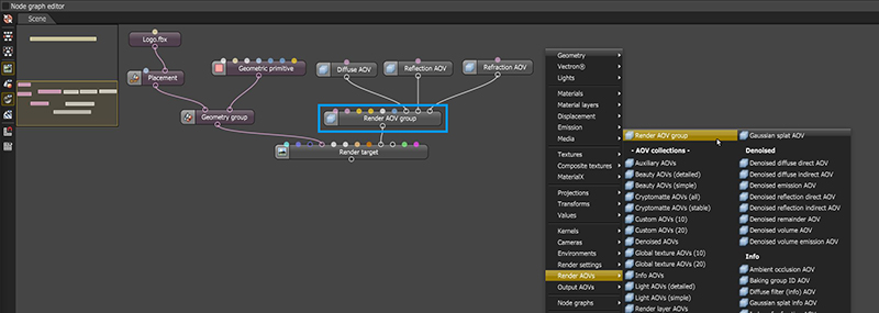

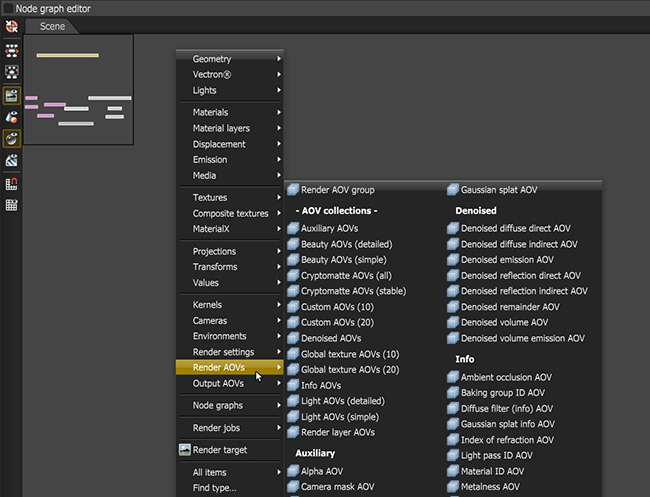

AOVs can be added as individual nodes in the Node Graph Editor window as well. AOV nodes can be added by right-clicking in the Node Graph Editor and clicking on Render AOVs (figure 3).
Render AOvs Node Graph Editor
Figure 3: Add AOV nodes in the Node Graph Editor window
Multiple AOVs nodes can be added and connected via a Render AOV Group (figure 4).
Render AOV Group Node
Figure 4: Render AOV nodes connected via a Render AOV Group node

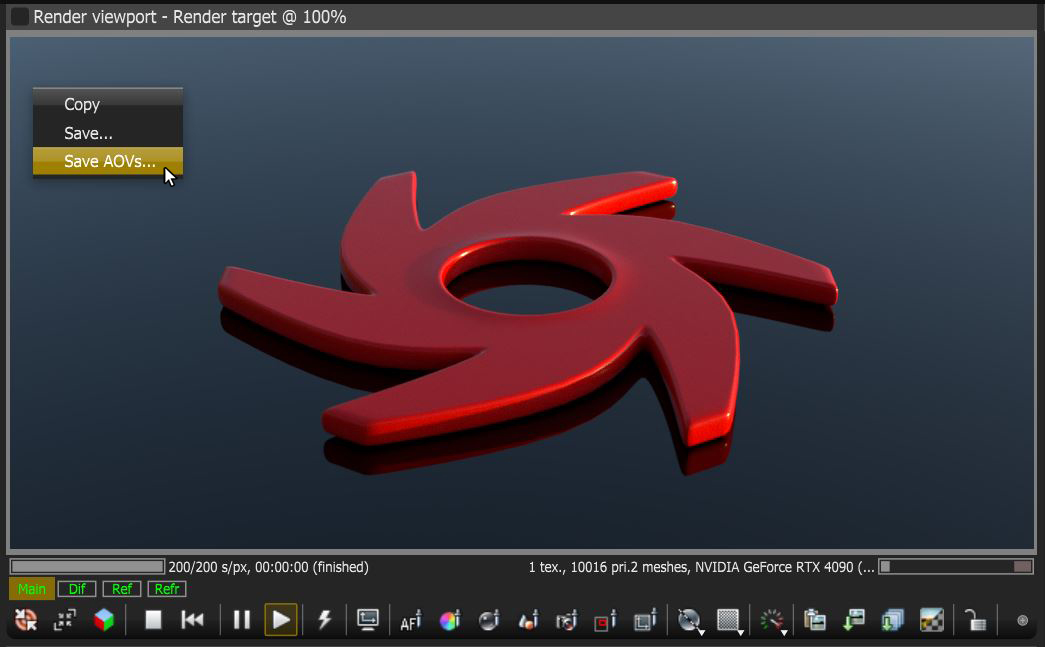

The Render AOVs can be viewed by selecting their corresponding buttons in the Render Viewport window (figure 5)
Viewing AOVs
Figure 5: Viewing the Render AOVs in the Render Viewport window
A rendering that contains AOVs can be saved by right-clicking on the completed rendering in the Render Viewport and choosing Save AOVs (figure 6). The AOVs can be saved as multi-layer or as separate image files. Animated scenes that contain AOVs can be rendered from the Script menu using Batch Rendering.
Saving AOVs
