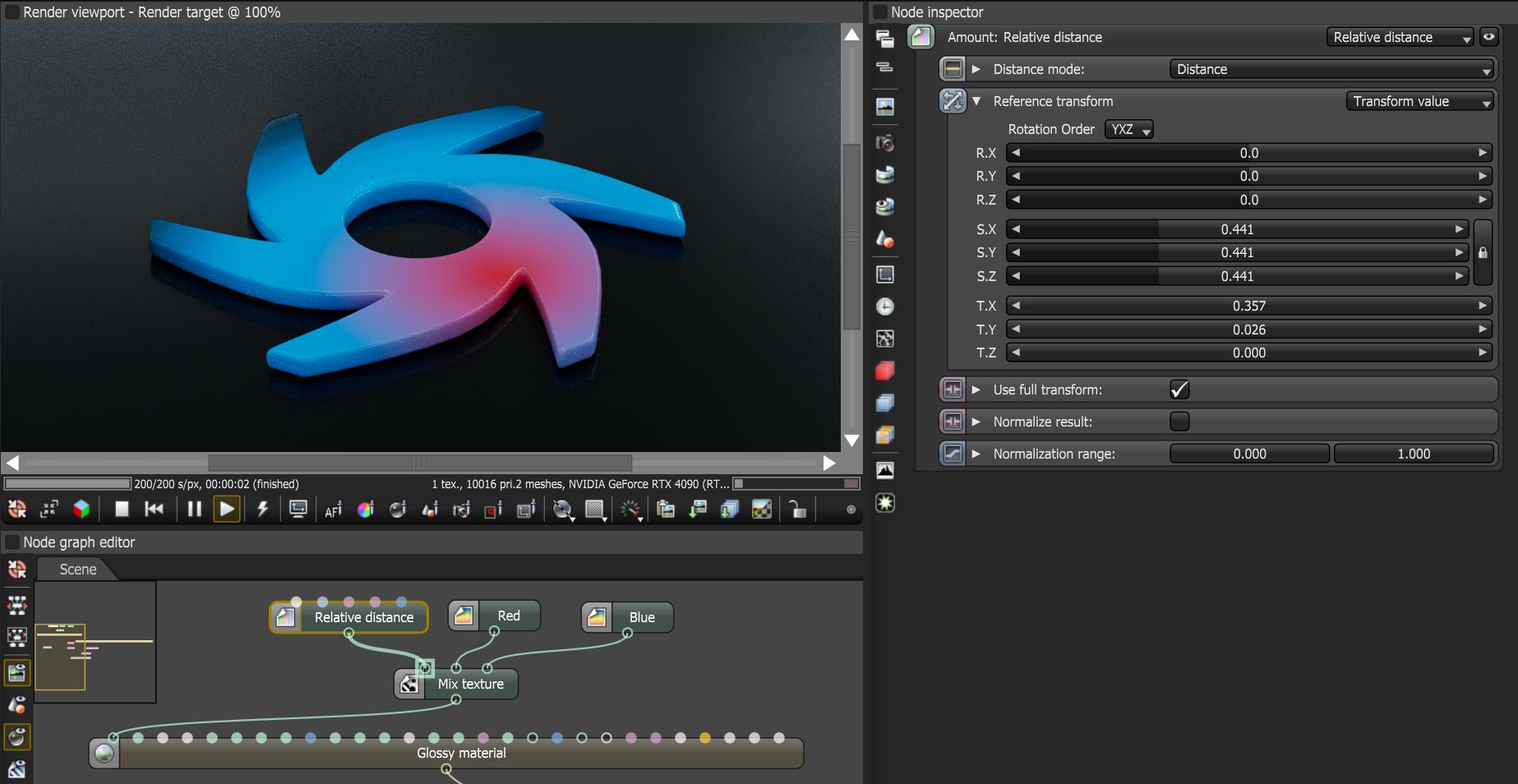

The Relative Distance node converts the distance to the origin from one of the specified reference transformations into a greyscale texture that can be used to drive other node data. In figure 1, the Relative Distance node is used to drive the mix amount for red and blue RGB Color nodes.
Relative Distance
Figure 1: The Relative Distance node connected to a Mix Texture node's mix amount
