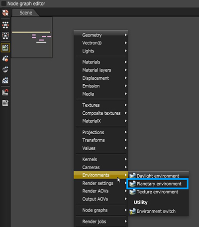

Figure 1: Accessing the Planetary Environment node from the Node Graph Editor window
The Planetary Environment node can be accessed by right-clicking in the Node Graph Editor, then navigating to the Environments category, and then clicking on Planetary Environment (figure 2).
