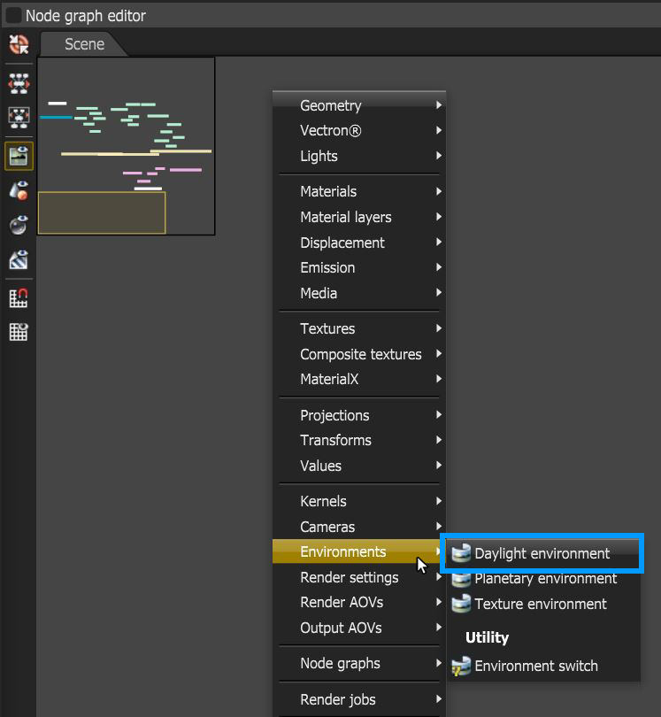

The Daylight Environment system simulates an outdoor lighting setup using real-world parameters (figure 1). It can be accessed by right-clicking in the Node Graph Editor, then navigating to the Environments category, and then clicking on Daylight Environment (figure 2).
Figure 2: Create a Daylight environment node

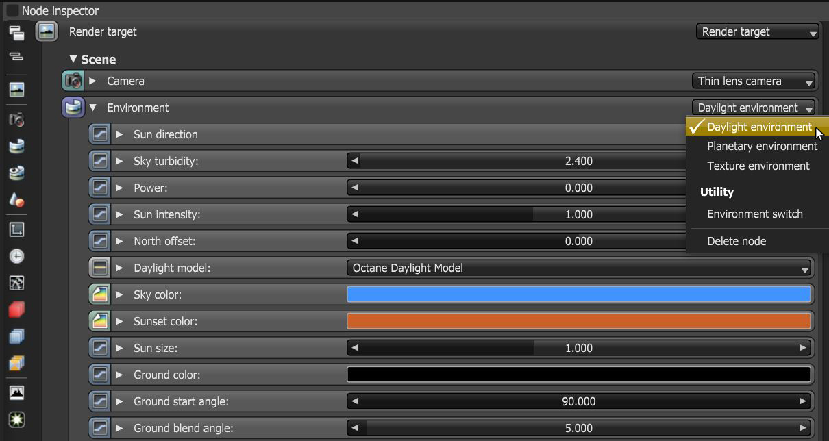

Switching to the Daylight environment can be done in the Node Inspector for the current Render Target as well (figure 2):
Daylight Environment in Node Inspector
Figure 3: Changing the environment to the Octane Daylight System

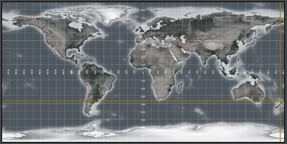

  • Interactive Map - The map can set the scene's geographic location. The sun's position can be set by dragging the crosshairs around on the map (Figure 4).
Interactive Map
Figure 4: An interactive map for sun position
