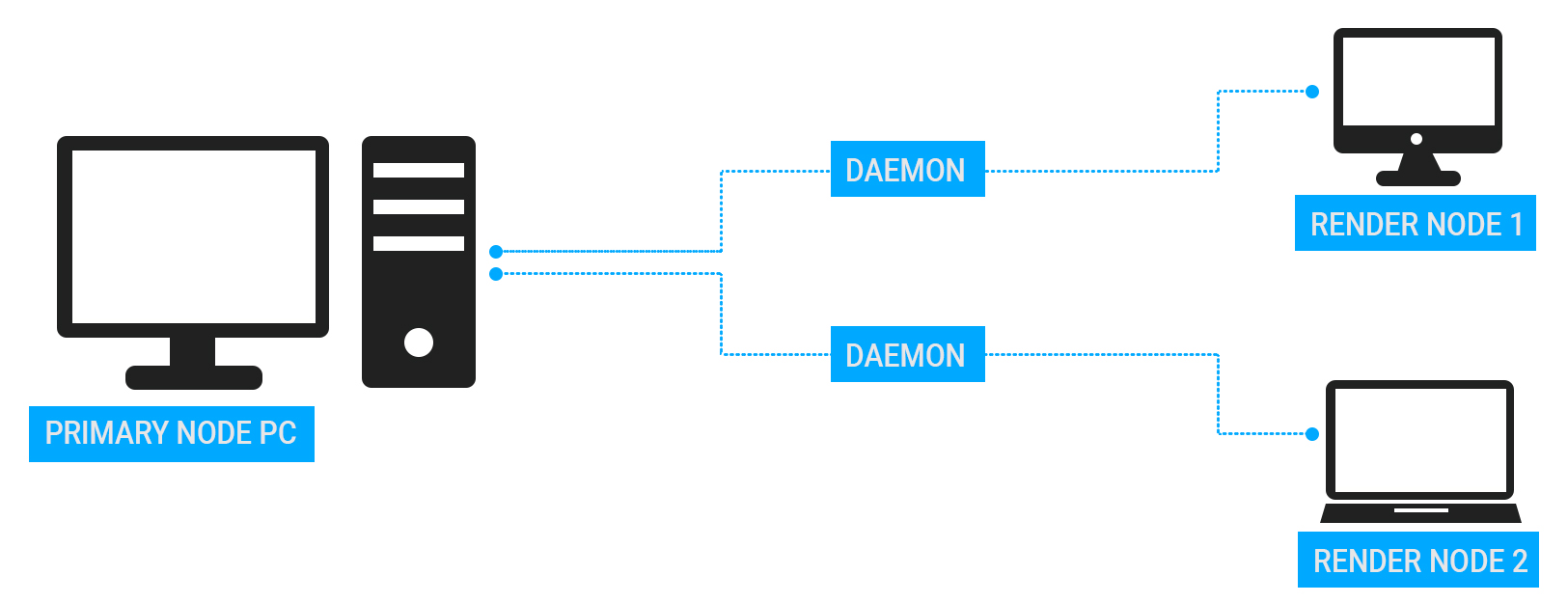

Render Node Configuration
Figure 1: Primary Node - Render Node configuration

When a Primary Node invokes a daemon, the Render Node launches to get some information about the number of GPUs, version, bitness, etc., and closes again. After that there is no Render Node process running, so the daemon waits for Primary Nodes to detect it by scanning the complete local network in regular intervals. The daemon should appear in the daemon list of the network preferences of the Primary Nodes. If it does not, it could be because:
  • The network rendering in the Primary Node is not enabled.
  • The daemon is listening on a different port than the Primary Node is scanning.
  • The daemon is in a different subnet than the Primary Node is scanning. If you have one ethernet adapter on the daemon and Primary Node PCs, you can ignore this case.
  • The Windows® firewall keeps the Primary Node from connecting to the daemon, or the daemon from responding to the Primary Node. To verify it, disable the firewall on both PCs. If the daemon is now detected (this can take up to 20 seconds), you can try enabling one firewall after the other to see which one is causing trouble.
When you enable a daemon in the Primary Node's settings, the Render Node launches and appears in the Primary Node's status bar. One Primary Node can activate one daemon at a time. If daemon is occupied by another Primary Node, you will see the daemon state change accordingly. The automatic port configuration is an option on the Primary Node that enables the same computer to use multiple Primary Nodes.
