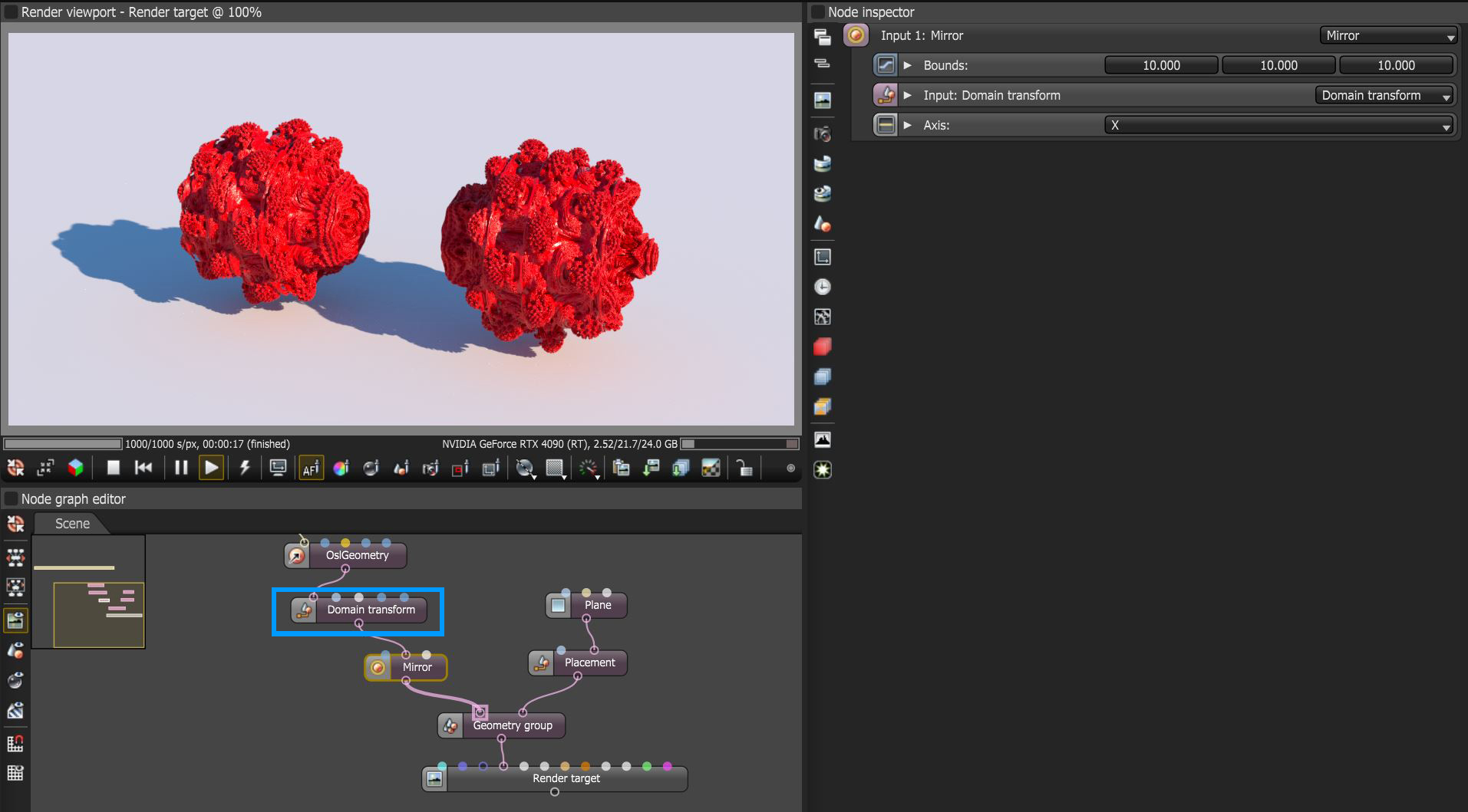

The Mirror node will mirror a Vectron object across either the X, Y, or Z axis. By default, the mirroring will occur at the origin of the mirrored object. A Domain Transform node can be used between the mirrored Vectron object and the Mirror node to adjust the position and rotation of the mirrored Vectron object (figure 1).
Mirror
Figure 1: The Domain Transform node used to adjust the mirrored Vectron object
