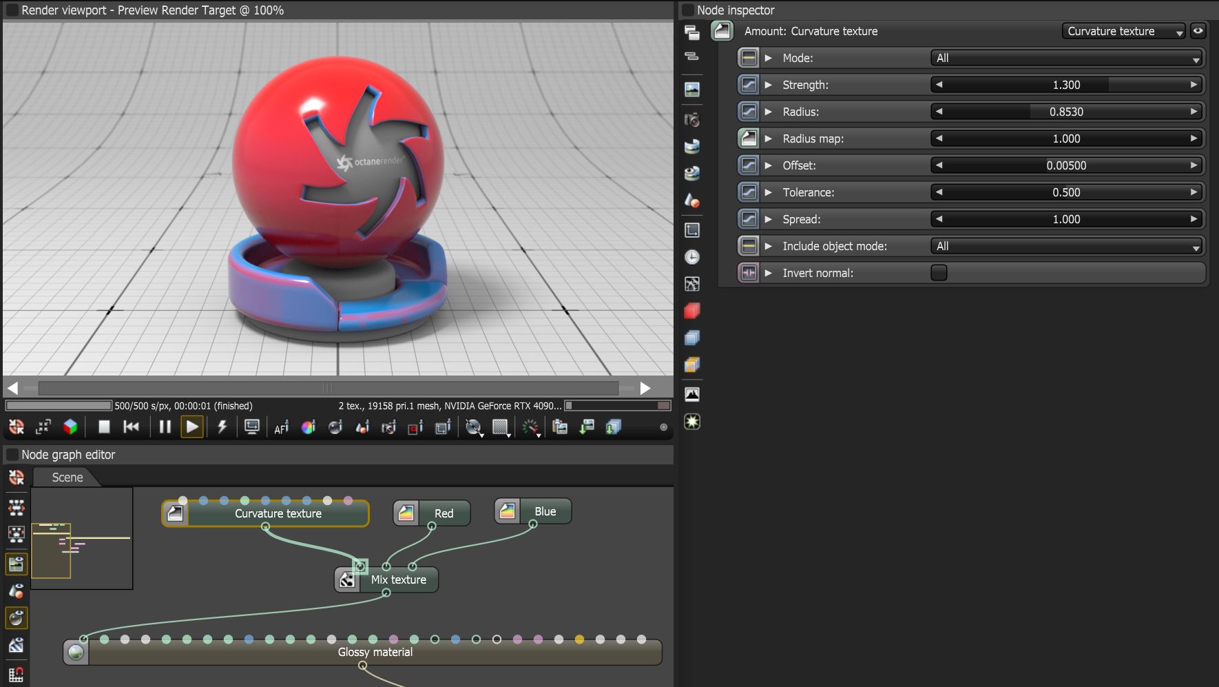

The Curvature Texture node can be used to alter the look of the edges of a surface. In figure 1, the Curvature Texture node is used to mix red and blue textures on a Glossy material.
Curvature Texture
Figure 1: The Curvature Texture node is used to mix Red and Blue RGB Color nodes on a Glossy material
