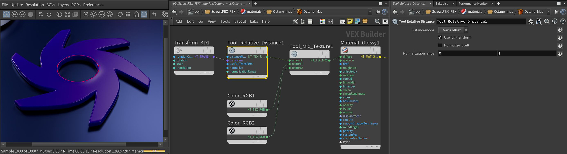

The Relative Distance node converts the distance to the origin from one of the specified reference transformations into a greyscale texture. Figure 1 is a simple example of using the Octane 3D Transform node offset in the Y direction as the mix amount for an Octane Mix Texture node.
Tool Relative Distance
Figure 1: Using the Relative Distance node as a mix amount for red and blue RGB Color nodes
